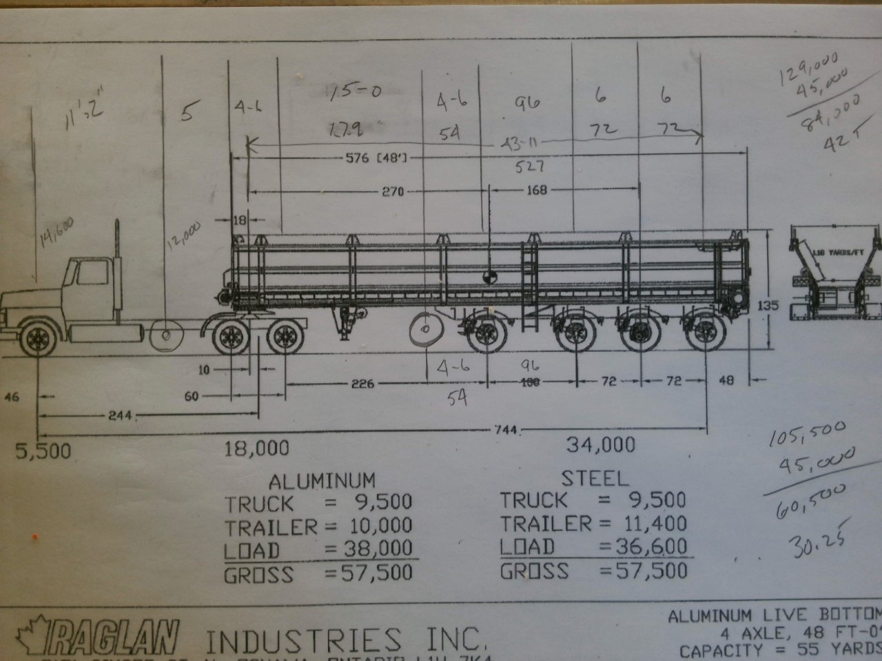

    Coincidently I'm working with it right now, can a fellow get 105,500 on 61'.....
