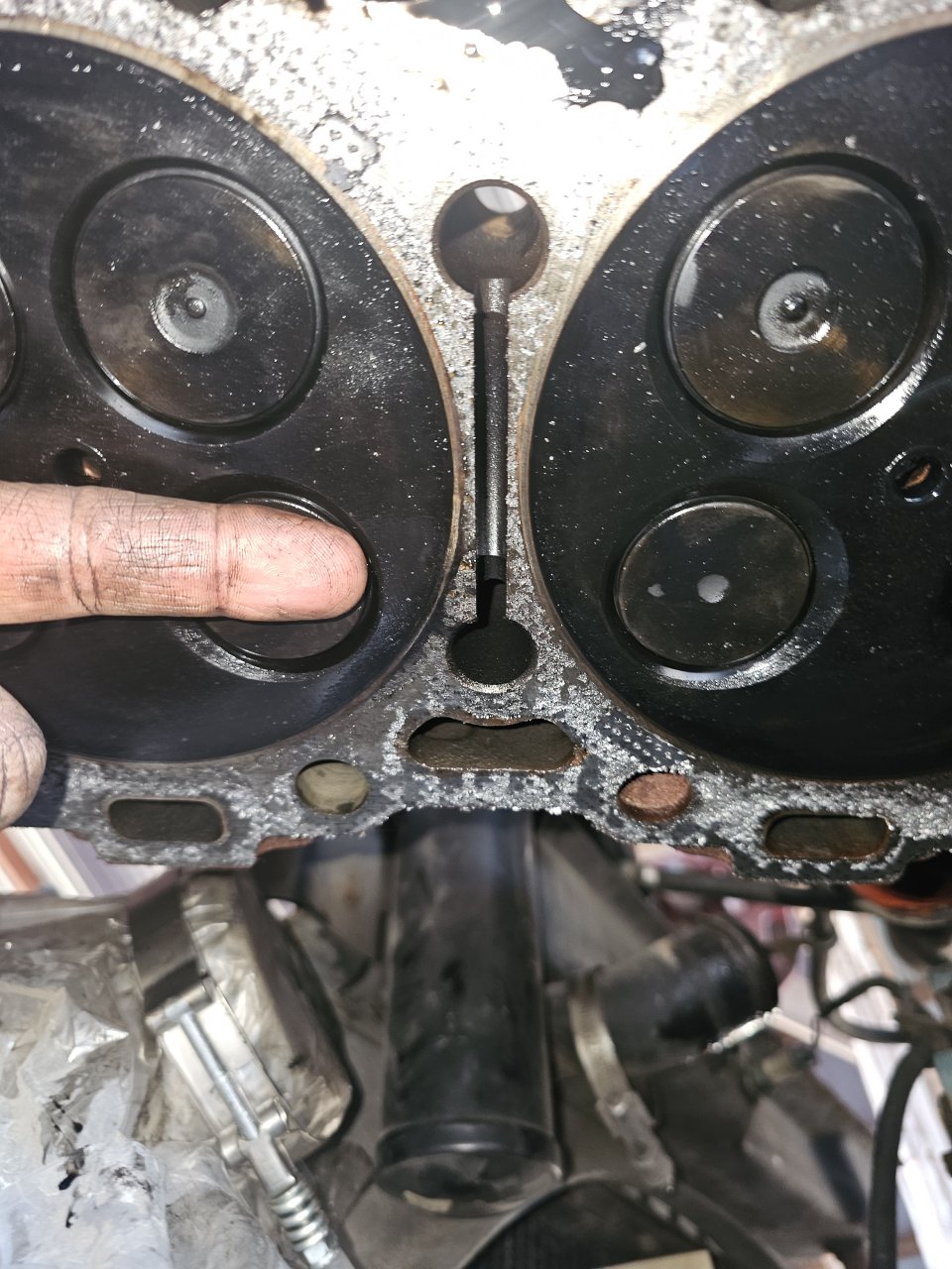

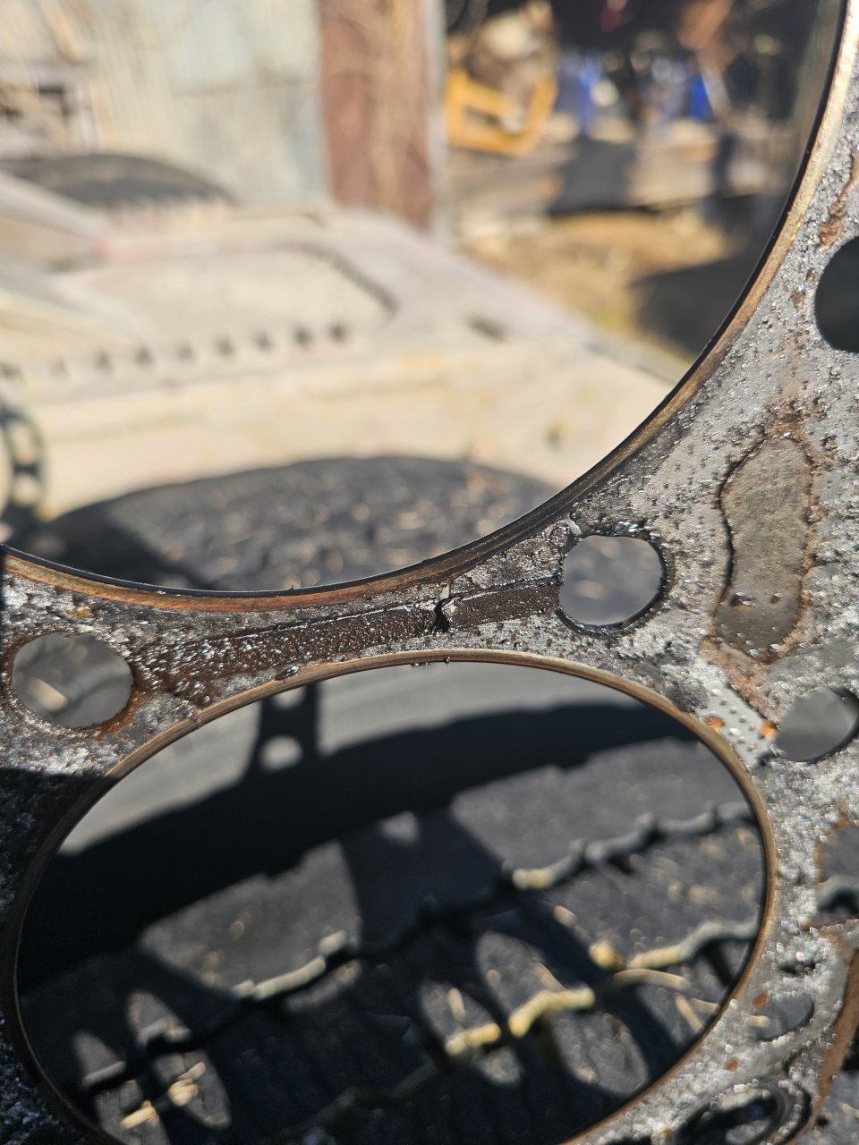

    Yeah, it's liner protrusion. On 60's they use what's called a salvage sleeve. It's about a half inch tall, and 1/4" or so thick. Cut the whole surface where the liner sets and install the sleeve.
    Freightliner is the only one around here that does it. I waited a week for them to cut it when I did the overhaul. Finally they called and said their tool was damaged, and had no timeline when it would be fixed.
    I couldn't get the tool at the time to cut it for shims, and the only guy who had those tools here I didn't trust.
    Detroit revised torque specs and a head gasket with a wider fire ring in 2003, and with those revised torque specs and gasket, they updated liner protrusin specs. Mine then measured -.001 between 5 and 6, and the new low spec was -.003.
    I figured then it was mainly to get trucks out of warranty by slapping a gasket on and rollin, the repair would last till it wasn't covered.
    Seems correct. It's blown in the same spot. It'll get a gasket until it needs another overhaul.
