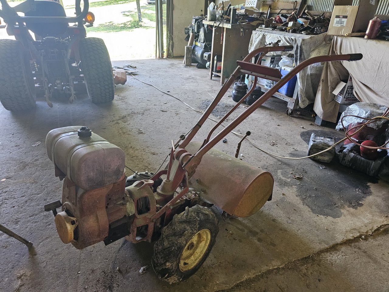

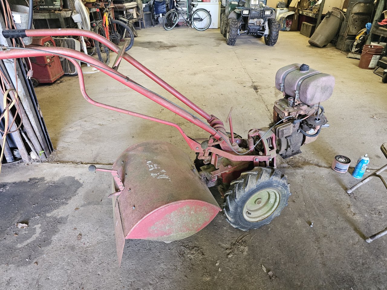

    Anybody have any experience with an old Tecumseh?
    My youngest needs a tiller for her new place, so I drug this outta the woodshed.

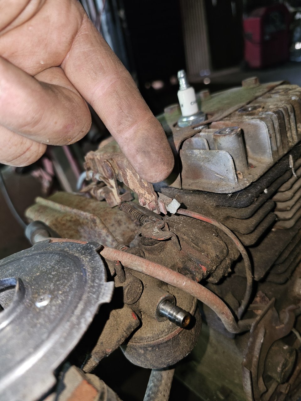

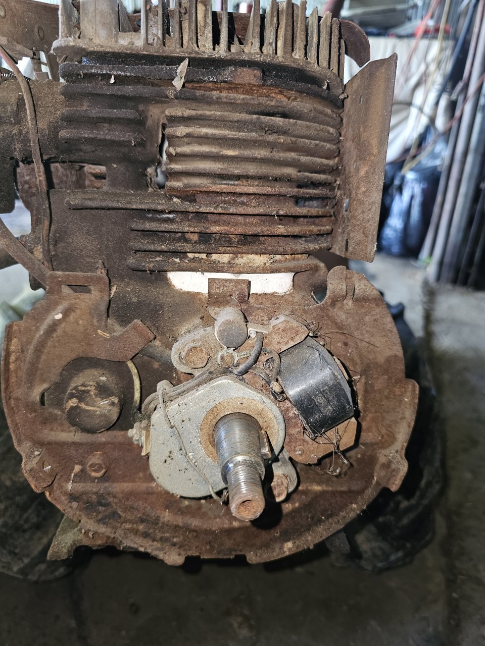

    No spark, and I don't see a kill switch, ground,
    etc. I'm assuming a kill switch would wire into this spade?
    So cut the fuel to kill it? I'm figuring it needs this coil? assembly and carb cleaned.
    It has compression, but I don't ever remember seeing this run.
    Anybody know if US made parts are available?

    Clean the magnets on the flywheel and the coil with sand paper or scotch brite. The points are probably under that cover where the crank shaft comes out they'll at least need sand paper and setting. That looks like a well built tiller maybe worth putting a Harbor freight engine on if that one gives you too much trouble. Clean the carb and gas tank also.

    Everything @50WT said, set the mag to the flywheel at .010 most feeler gauges have a brass one for this. Lots of ol timers use a match book or a business card for it. I thought I could still remember the points setting let me think on it for a minute.

    Pretty sure it’s .020….

    I think so too

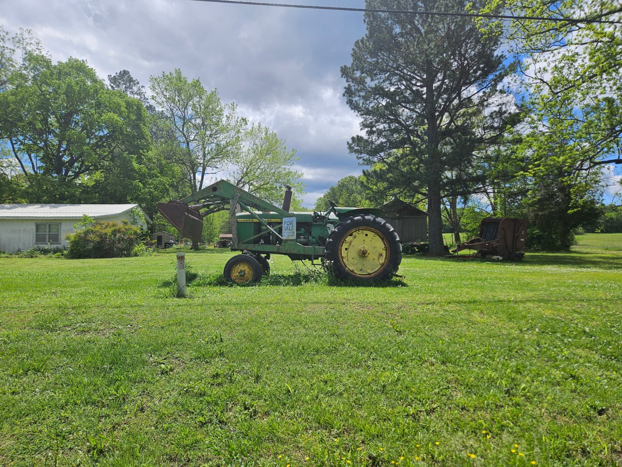

    9213991737886068257.jpeg So I stopped and looked at this gem today needs a clutch and a tune up. My bride immediately blamed a friend of mine…..So in true pursuit of the little tractor I got a hold of the best tractor salesman I know and between us we got her leaning our way. @OLDSKOOLERnWV

    Looks like a horse model, have one in the shop with a B&S. Nice tillers.
    As already mentioned clean the coil and magnets in the flywheel. Clean the points gently and clean in dust / lint out with a folded $1 or any paper $$, it works the best. I have a smaller Tecumseh on a jr model Troy-Bilt.
    Sometimes just a good cleaning on the coil and magnets makes a world of difference. And yes on the ground wire to the spade, my Tecumseh is that way as well….

    I’m telling ya, I see a homeowners best friend right there, from normal yard work to flowerbeds and additional landscaping work on future projects. Not owning that tractor is like a man wearing a shirt without a pocket, or a woman owning only 1 pair of shoes. Tell her she will thank me later on…. :D
