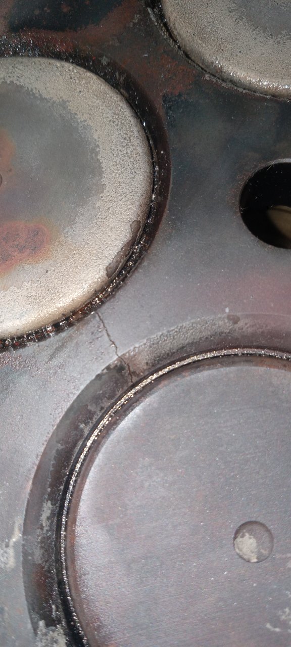

  11. Isafarmboy
    Isafarmboy Road Train Member
    3,044
    33,351
    Jul 2, 2018
    Alberta
