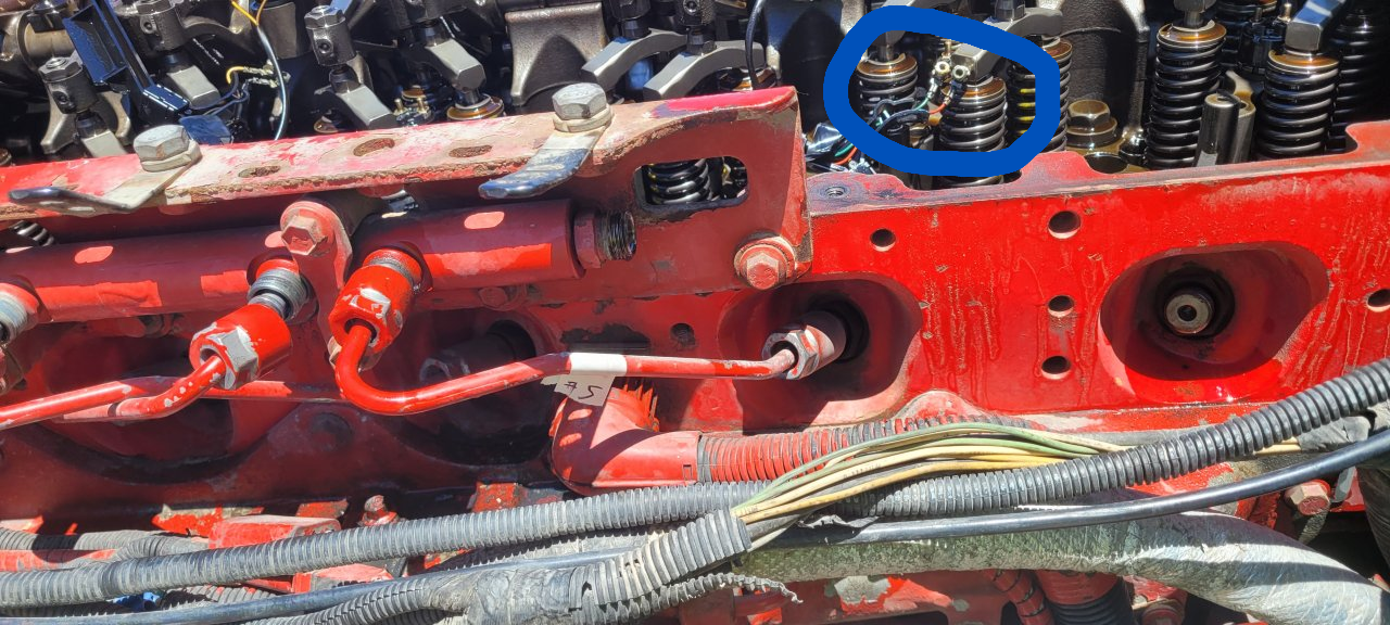

    He pulled the injectors to pressure test the cups that’s just where a set of the wires landed…just a guess

    Oh yeah, that would make sense. I'm a dummy.

    I’m not sure about that lol

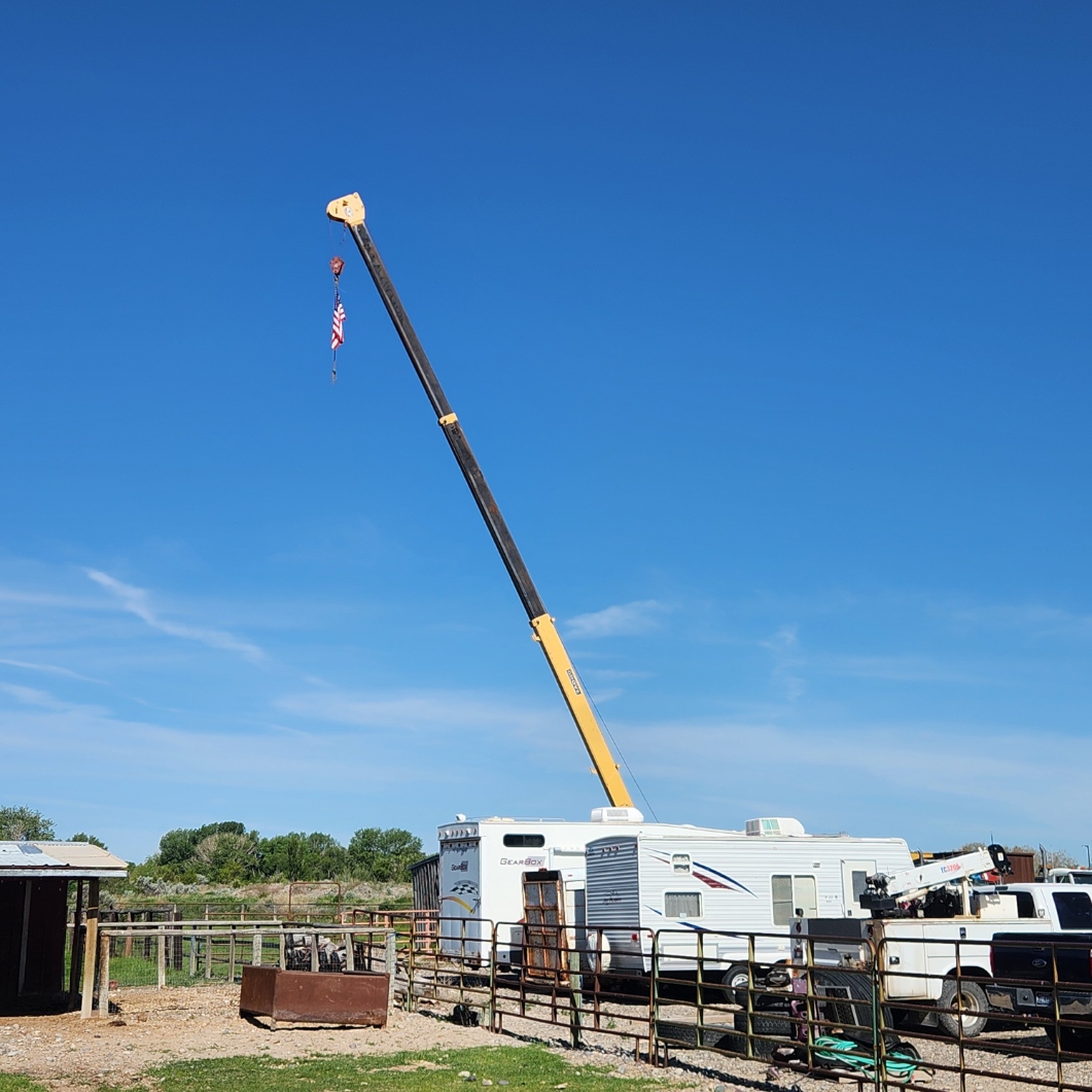

    Found a use for the new toy:
    Have a good Memorial Day, and thanks to those that served and especially those who gave all.

    Yes that what it was, injector harness just pulled out of the way
