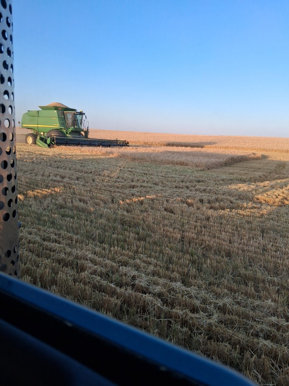

    Yes it is. Look at all of those John Deere’s!! lol.

    Dunno how gramps did it without a cab. We are a buncha spoiled brats.
