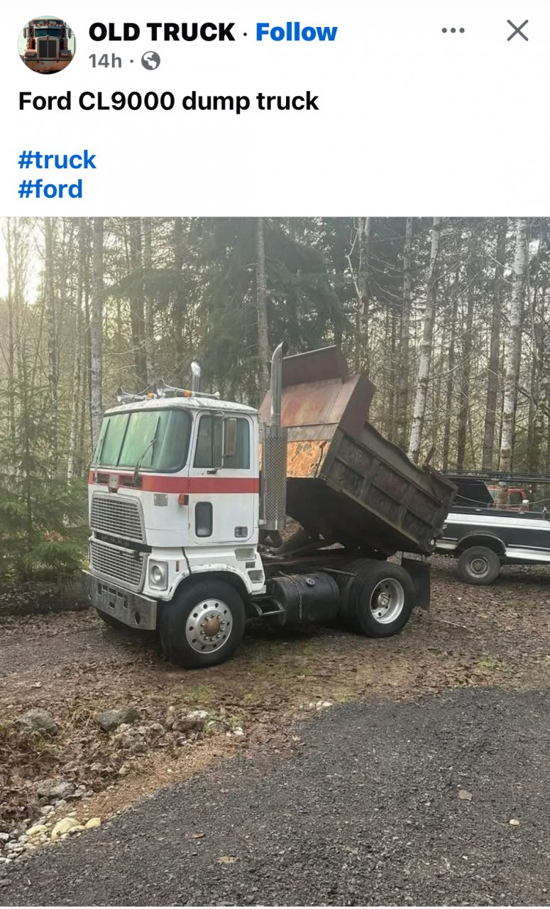

    @Oxbow you need a dump truck for close quarters….? :)

    Better get some airtabs to be on the safe side.

    Ha, I bet the ride in that little rascal would put some NFR bucking horses to shame!
    Thanks, but I'll pass
