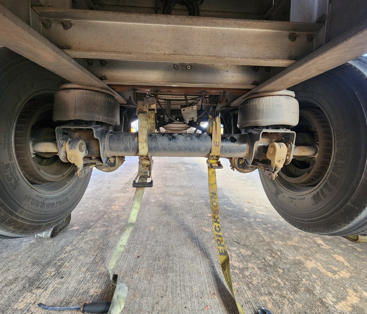

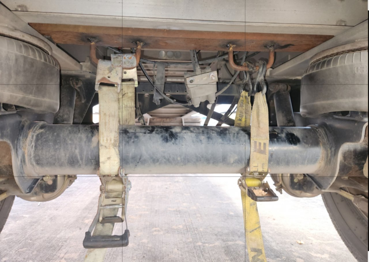

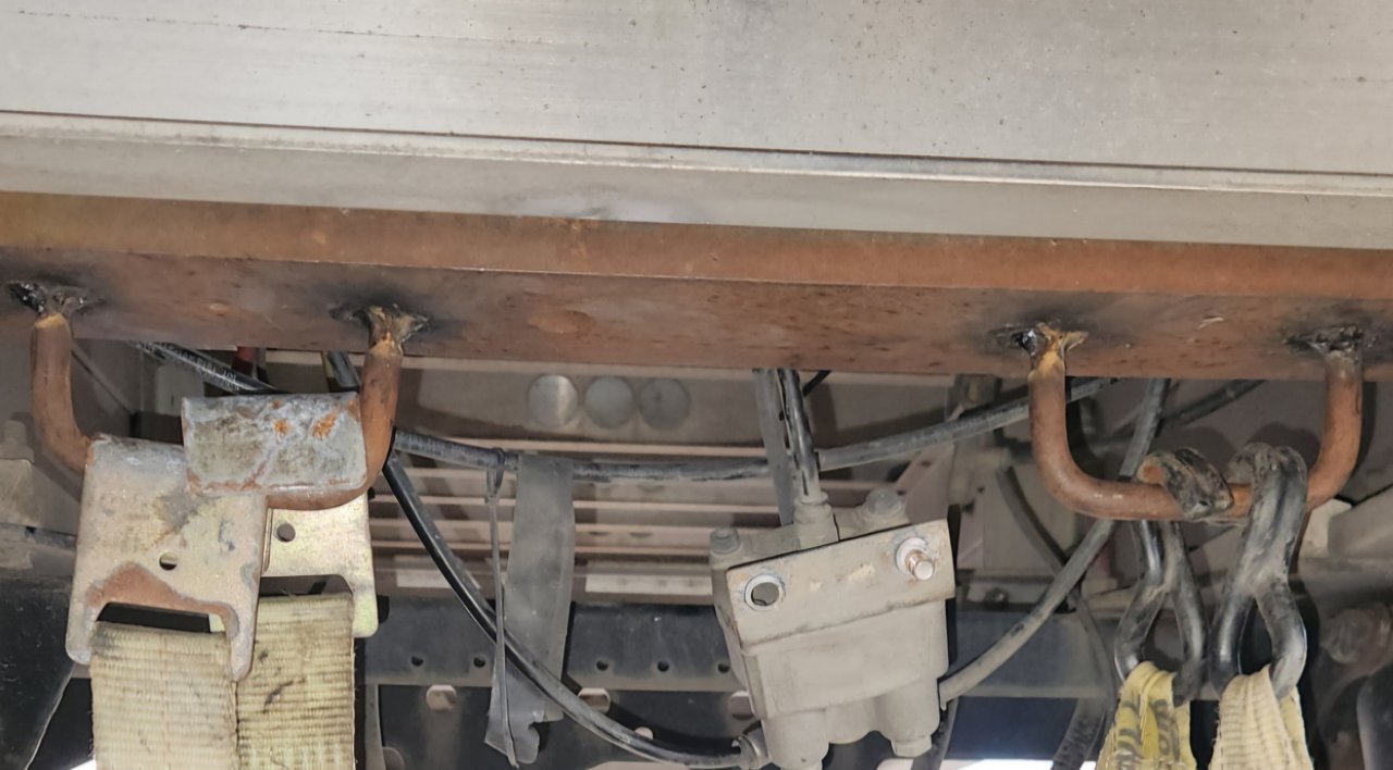

    No. I've been planning on buying a new trailer with a slider, but have kinda talked myself out of it due to weight.
    So, I checked on the underbeam lift from Hendrickson. It's only 500$ or so my Pete dealer says, but figured it couldn't take much to make one myself.
    I'll have to add a shutoff valve to the front axle line to the bags, and I'll have to add another valve to let the air out of the bags.
