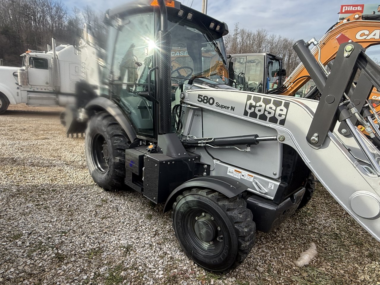

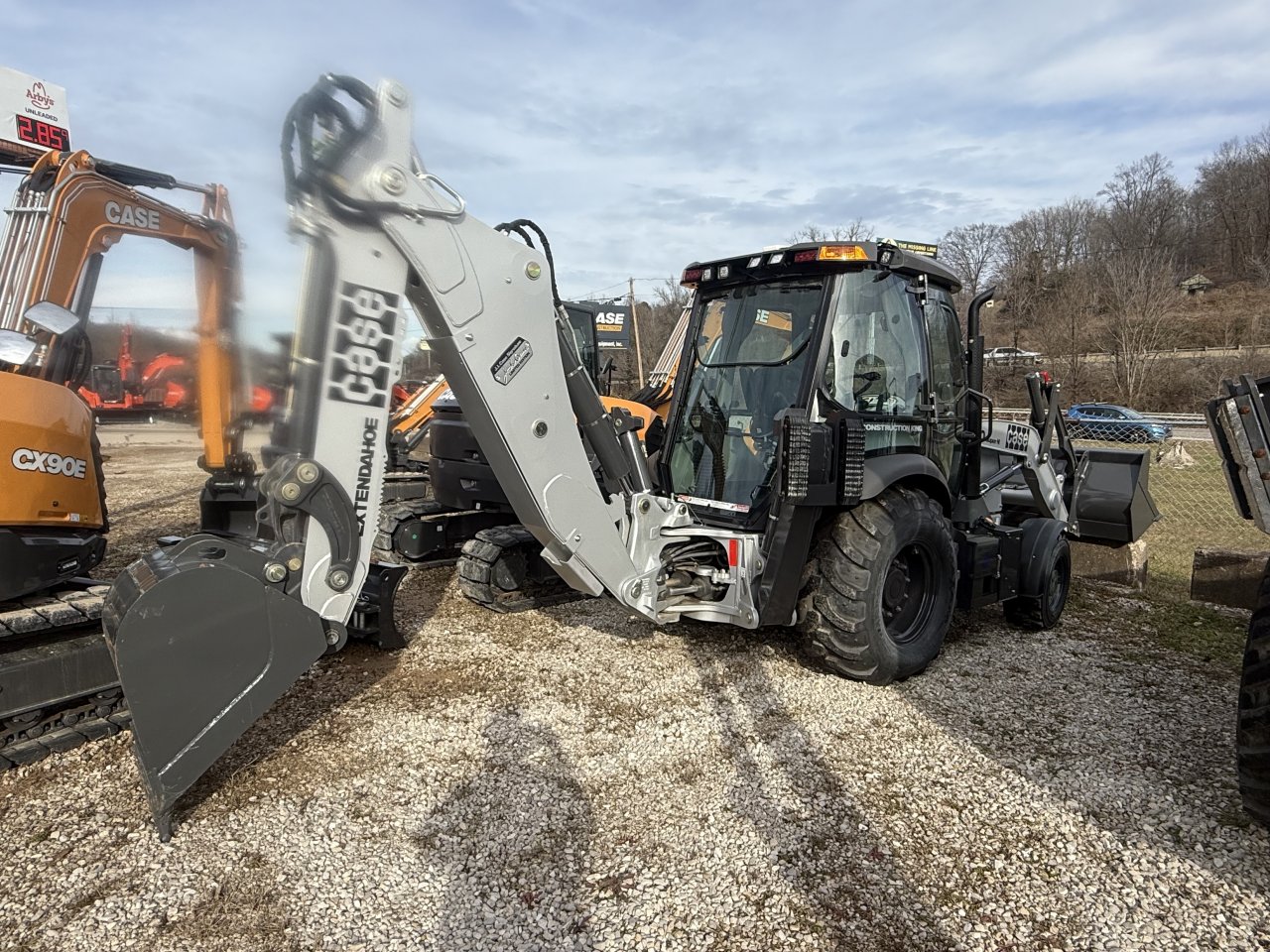

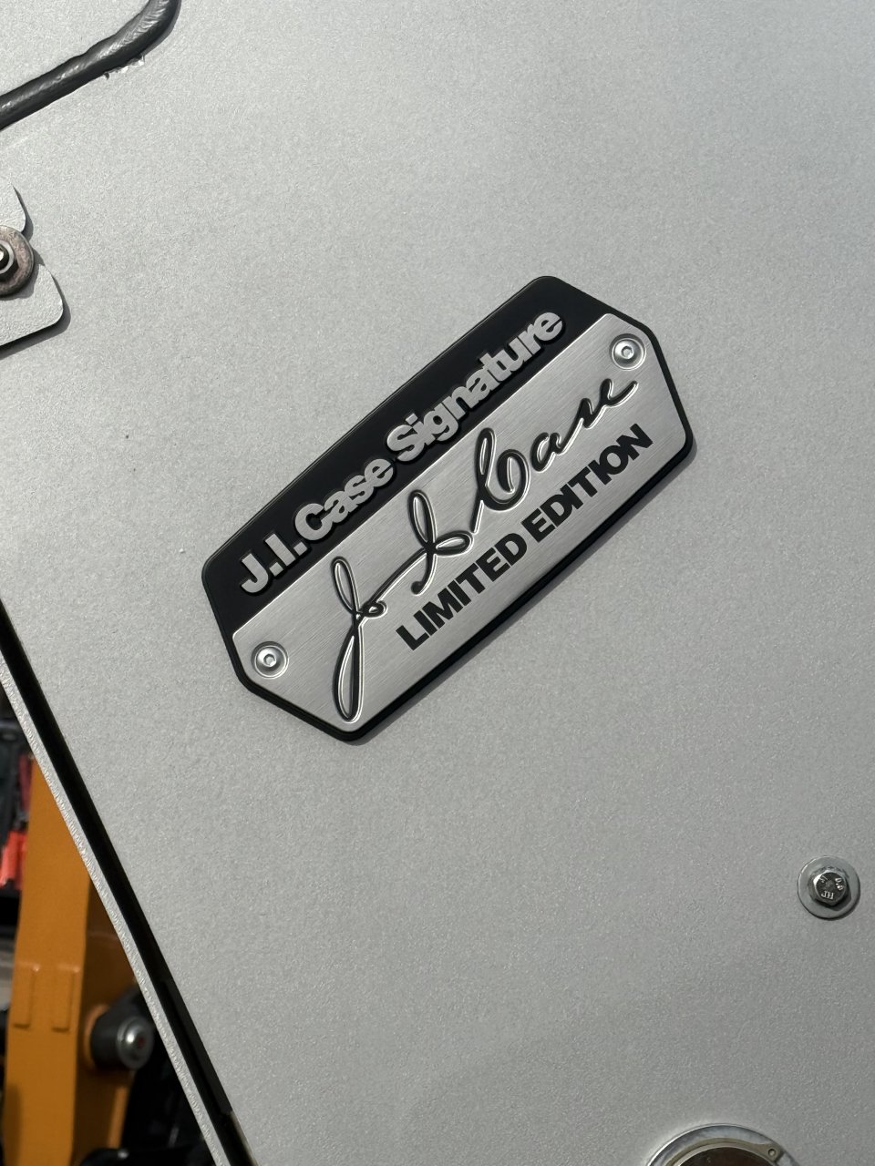

    Pretty intelligent man, came up with the reaper before Deere did the plow, but not really in production till afterwards if memory serves me.
    McCormick, Deere, & Case were all 3 big innovaters of agriculture equipment during the 1800’s, guess we can be thankful to all of them….
