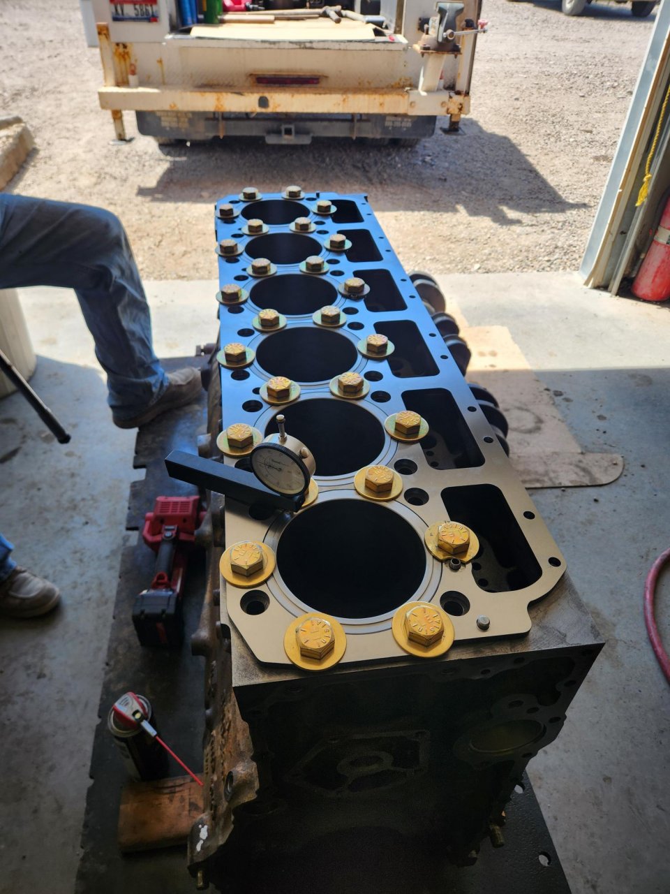

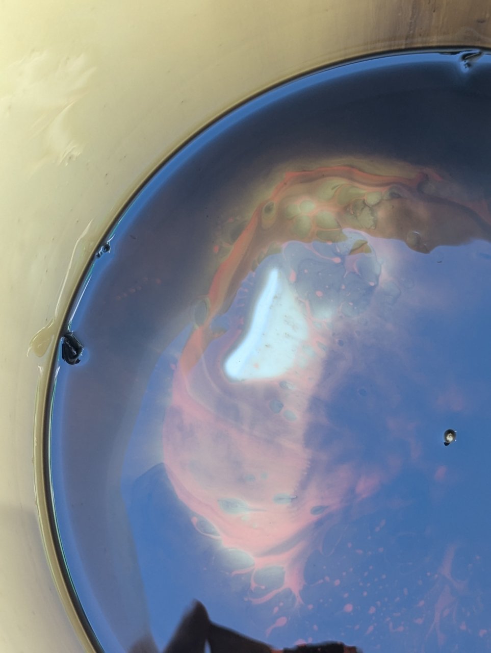

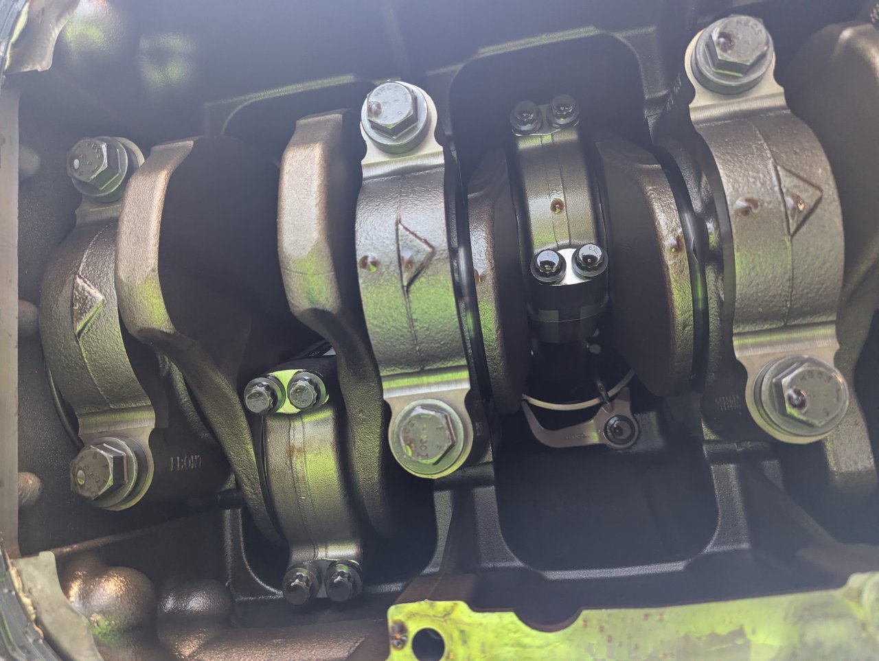

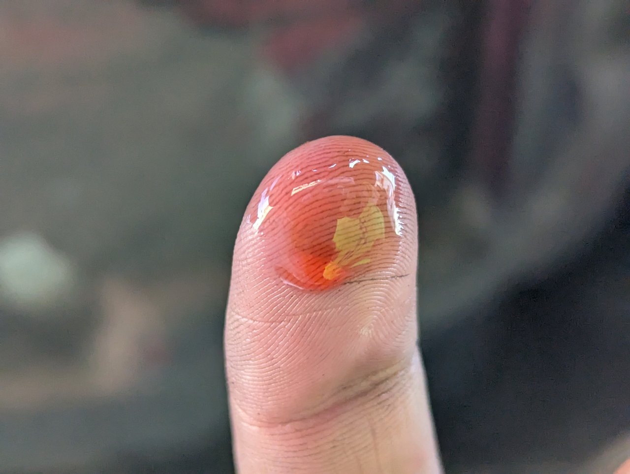

    I must be slow as hell good thing i dont get paid to wrench fer a living . :D Been busy around the house, but now getting back to working on my rig... Remeasured the liners again after cleaning the surface real well and buying a proper liner press tool to get a better clamp on it than i had. found #5 was .005 and .006 on exhaust side and .010 on intake side... The rest were all .009 and .010.. #6 was between .008 and .011... looking over head gasket again it confirms it. Lots of carbon around the ring on exhaust side #5 and a bit on #6

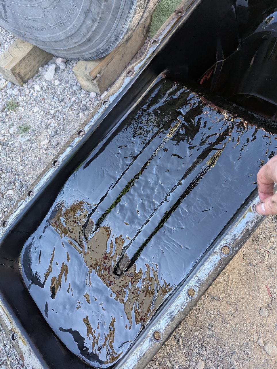

    Pulled pan off this afternoon and lots of sludge in pan and has traces of coolant in it.. also coolant drips on #5 cap underneath..
    well i guess i found the problem finally. ####

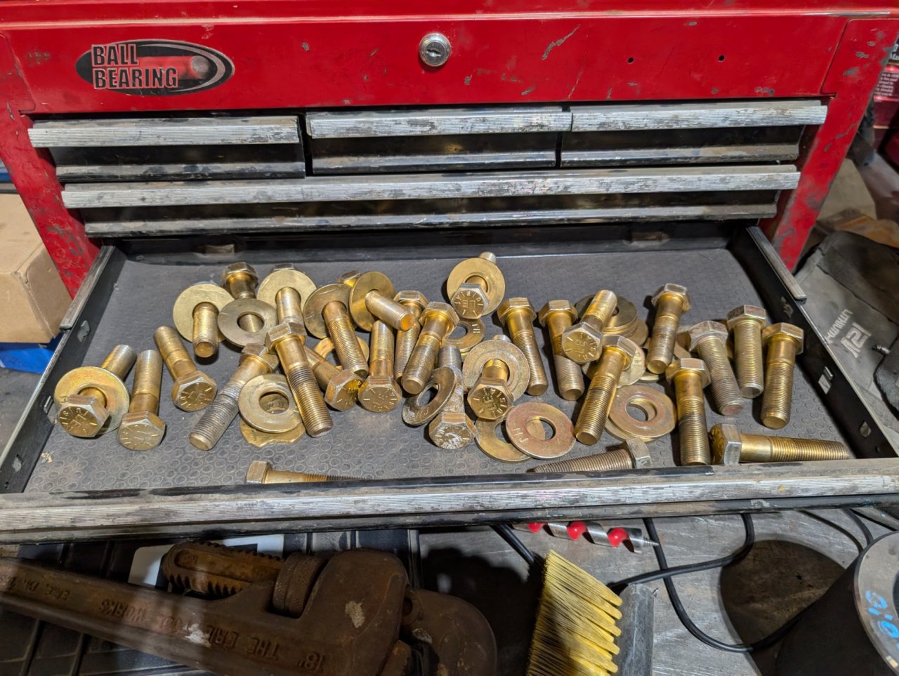

    I'm not familiar with the tool to press the liners. This is how we checked our b model after the counterbores were cut.
    I saved these brass washers and bolts. Probably different bolts for your ISX though.

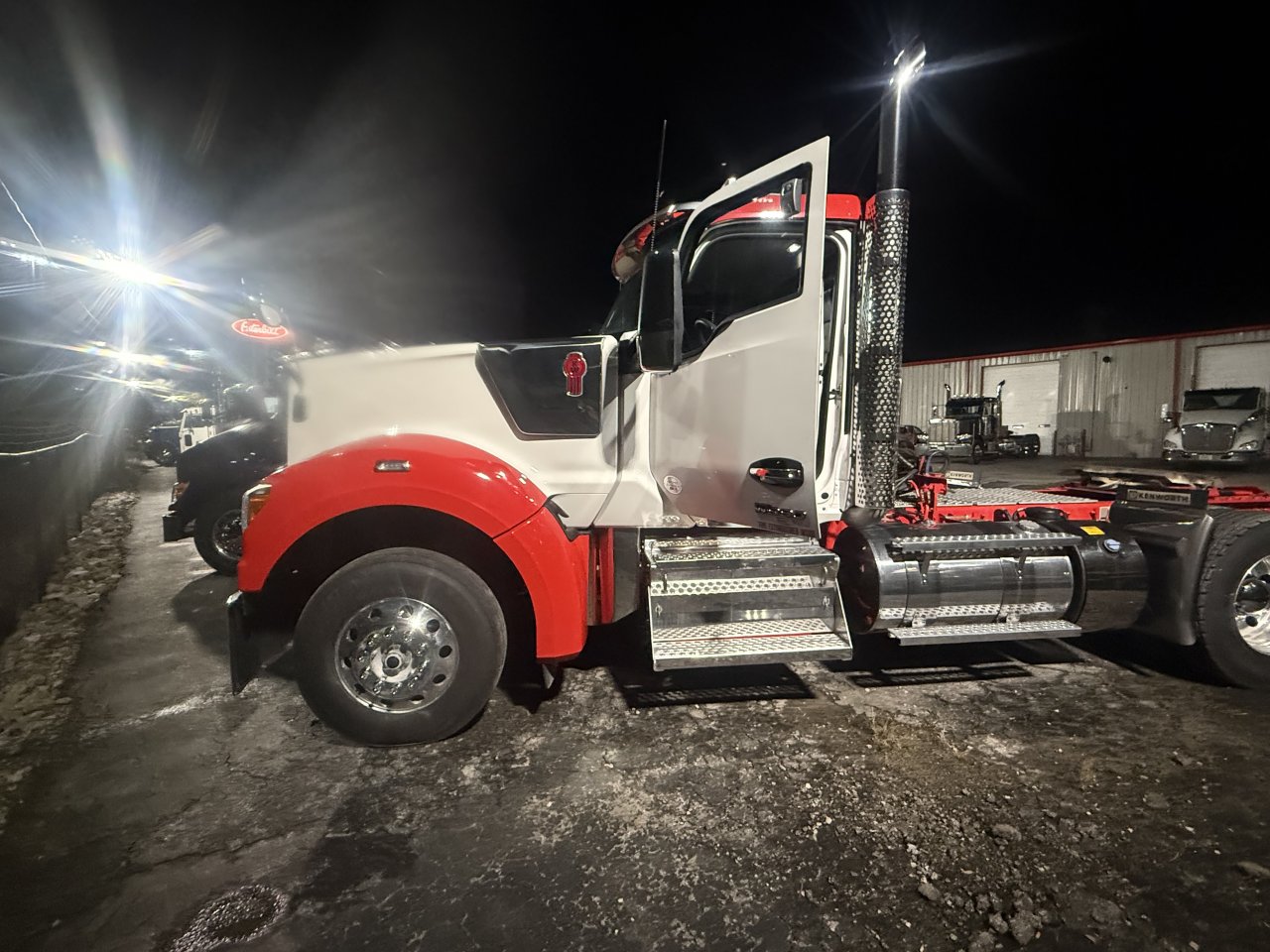

    Cab, windshield, & hood is not really to my liking for a Pete….

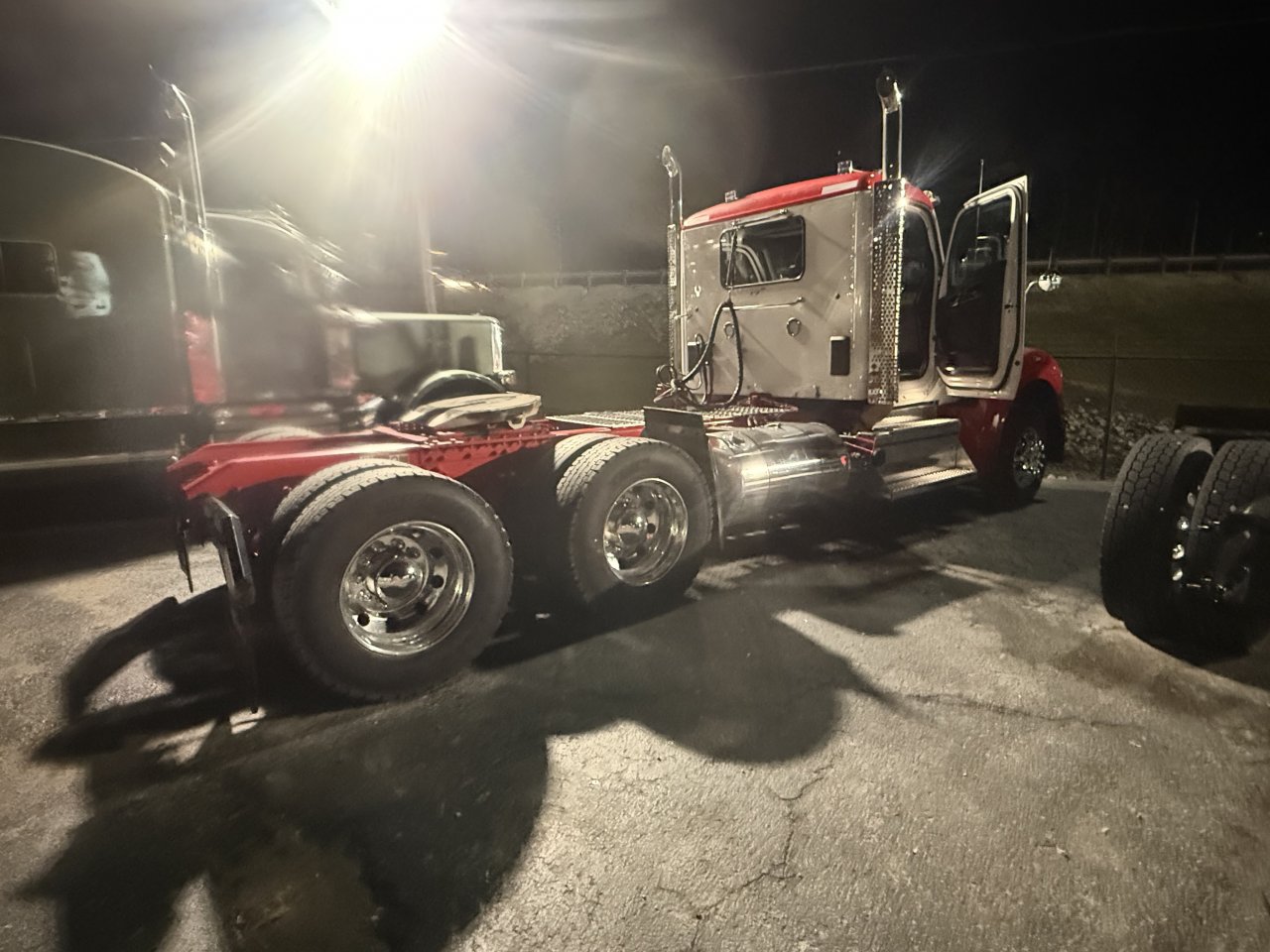

    The KW is supposed to be the ride back to WV, and it won’t crank over…o_O
