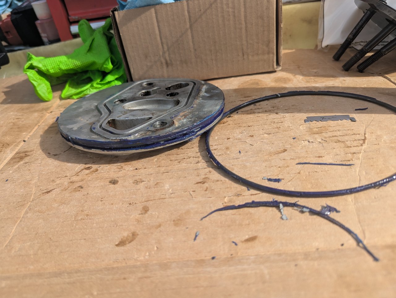

    I don't use silicone much, basically just a few areas on some oil pans snd valve covers. I do use anaerobic sealer on some o rings though, and that’s one of em.

    I been using a little bit of anaerobic, but very lightly.. this blue #### is on evrrything it seems like.. they even put it all over the head gasket around the oil galleys, they were almost completely plugged off. Im honestly surprised none of it ended up plugging the motor up

    Thats what i figured they did.. dont wanna replace a 2 dollar oring so use 18 dollars in silicone instead...lol

    I had to do some engine work last summer when a guy quit with it about 90% back together. I had to tear back into it and I cussed the whole time. He put anaerobic sealant on both sides of every gasket. At that point why even bother putting the #### gasket in there? Took more than twice as much time to scrape the gasket off in tiny pieces than to have just hit the dry anaerobic with a surface prep disc.
