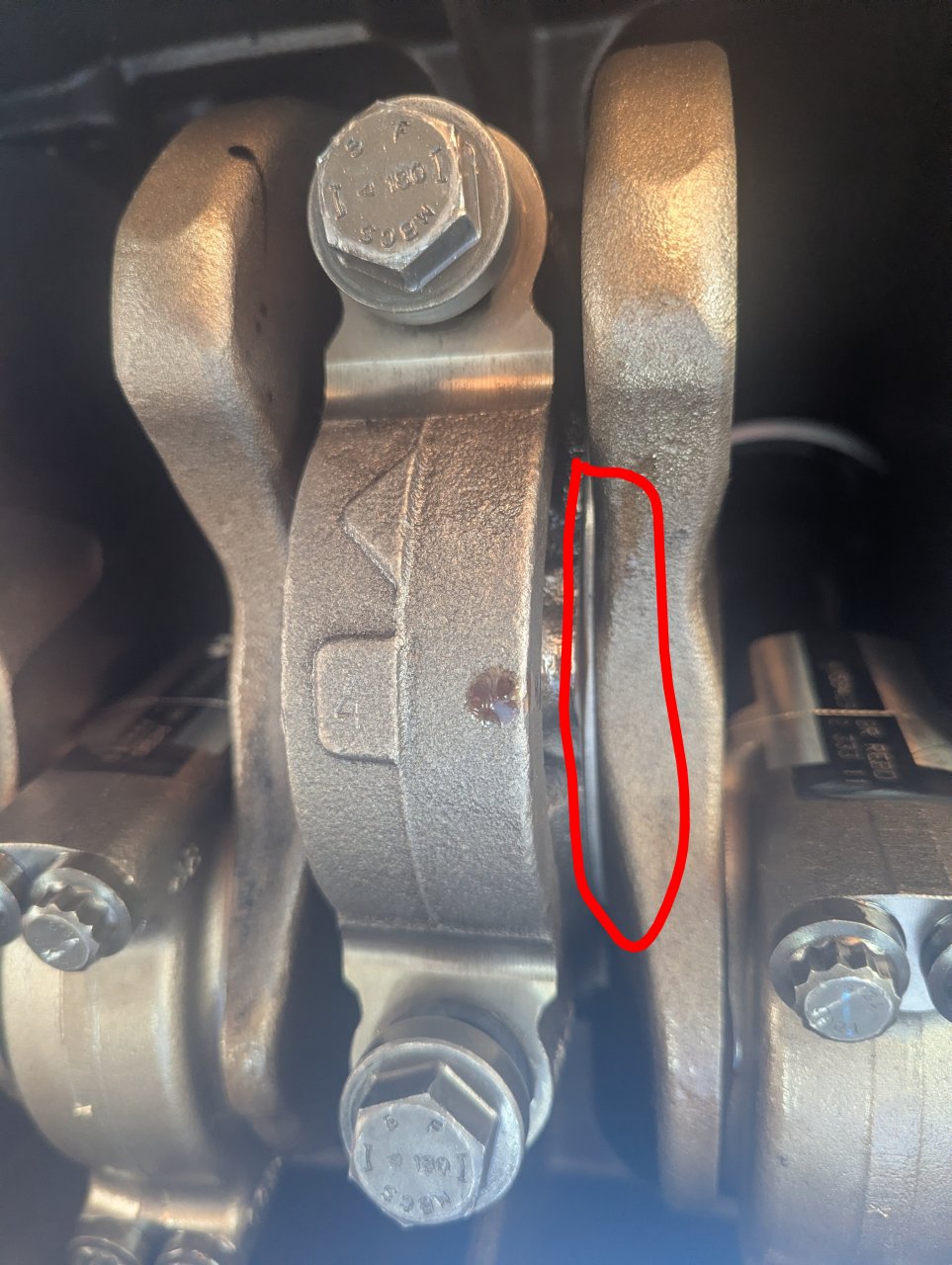

    Do u guys have any tips for getting these thrust bearings out from the main cap? I saved this one for last and its a bear trying to get them out. The cummins book doesnt say anything other than to remove them before pulling the cap.. PXL_20260124_201044709~2.jpg

    I always pull my cap then roll my bearing out of it. The washer will have this retainer type clip on it once you get cap off it will come right off

    Thanks. That was the ticket! Idk why cummins say remove the lower ones first with the cap on i think its impossible.. that cap was a pain to get off but i finally got that dirty dog out of there . The upper ones rolled out super easy PXL_20260124_213413820.jpg

    The way every crankshaft thrust bearing is that I have come across so far, if it comes out with the cap in place it will be sitting in the bottom of the oil pan lol.
