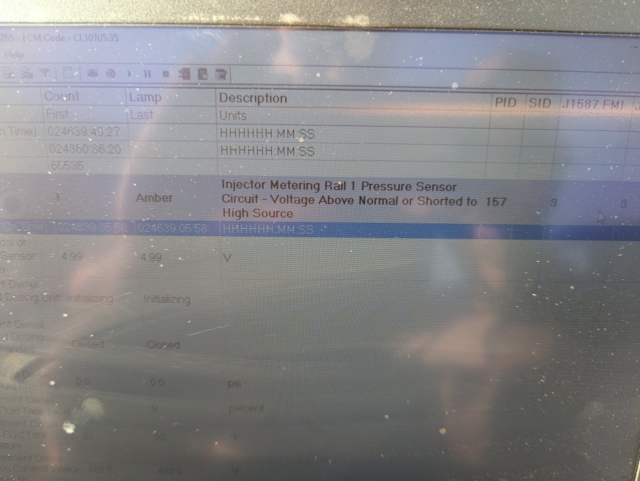

    Got it running , have good oil pressure and everything else seems to be good
    But its surging really bad at idle. Like its missing on 2 or more cylinders. New fuel filters and all the basics. The roughness goes away mostly when raising the rpm but comes back bad at idle. Fuel injector issue? Im waiting for insite to load so i can pull the engine code PXL_20260214_224056353.jpg

    Injector metering rail 1 pressure sensor is the only active fault code we have. SPN 157 FMI 3. Could this be related to the injector harness?
    Gatordude, DeereRunner97, cke and 5 others Thank this.

    IIRC that fault will come up if the ECM sees high signal voltage to the rail pressure sensor. I'd start by verifying the sensor is plugged in.

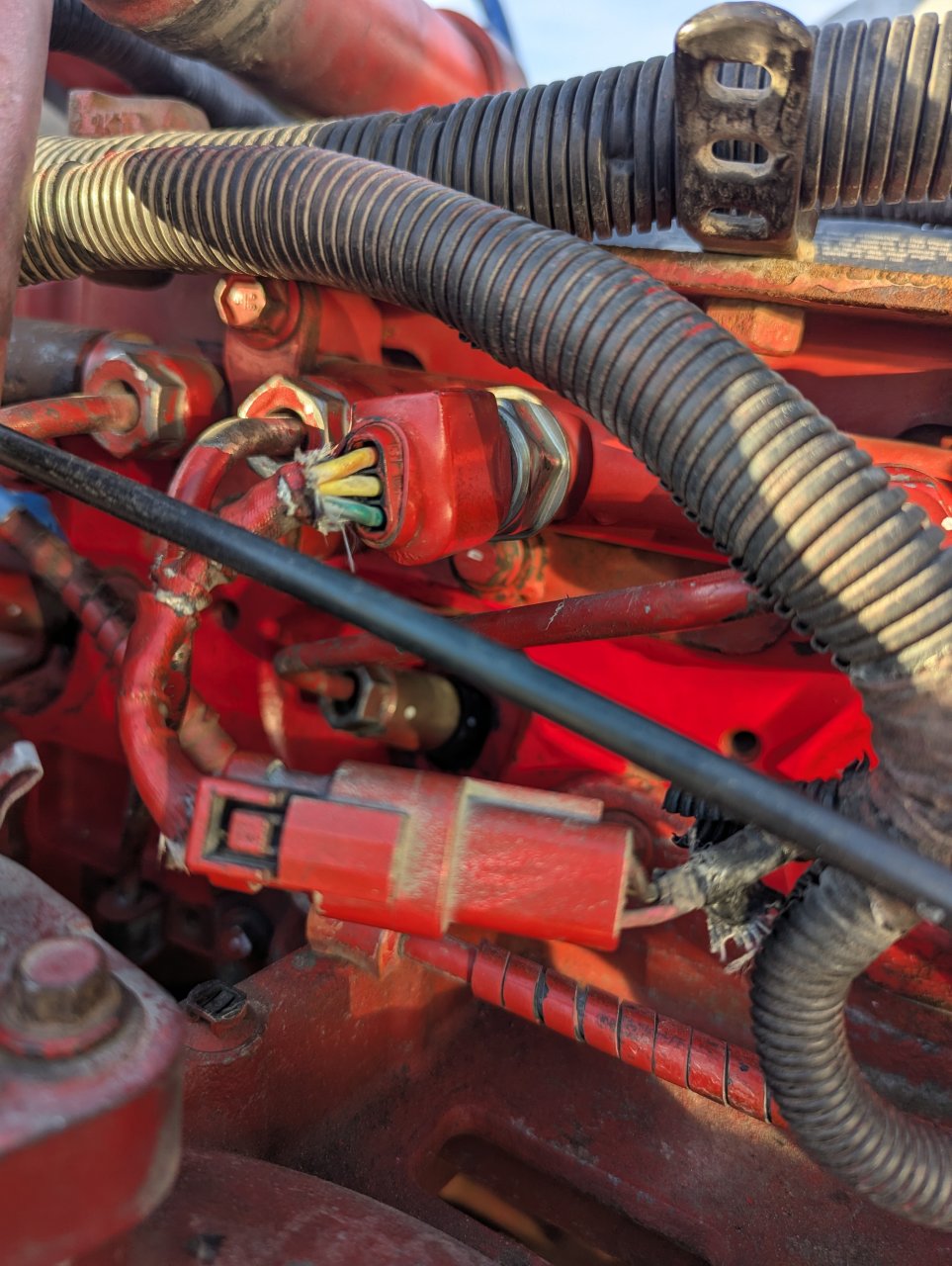

    Thats what im thinking too. Everything looks to be ok that i can see. Definatly didnt have this problem prior. This right here is the fuel rail pressure sensor . Ill have to do some research and see what it should OHM out at? and work my way inwards to the injector harness. I never touched that sensor on the fuel rail when i pulled it off so maybe its just no good anymore and needs to be replaced.. thanks for the help

    Check the contacts in the plug for it and make sure the terminals aren't spread.
