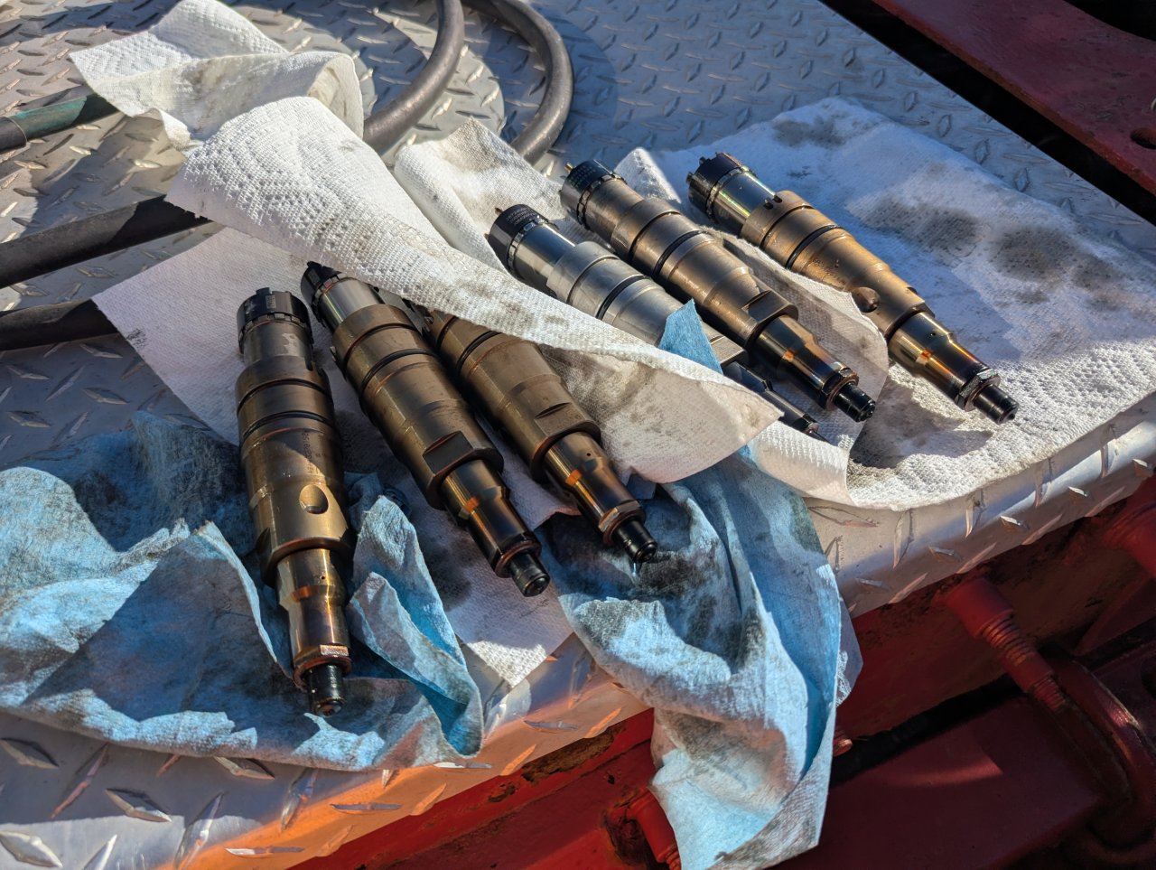

    Well all the tips are still on them so i guess one just got stuck open? Is there a way to bench test them? PXL_20260318_233747789.jpg

    Are you sure no valve adjustments moved, or Jake actuator hung open?

    it seems ok . The overhead is still the same as i set it. And the injectors are only electric controlled no rocker arm adjustment to make. I think one stuck open i just dont know how to tell. I cant get a good view down into the cylinders

    Testing electronic injectors is pretty specialized. We just ship them out to a local fuel injection shop and let them test them. They can usually get us remans pretty cheap if needed.
