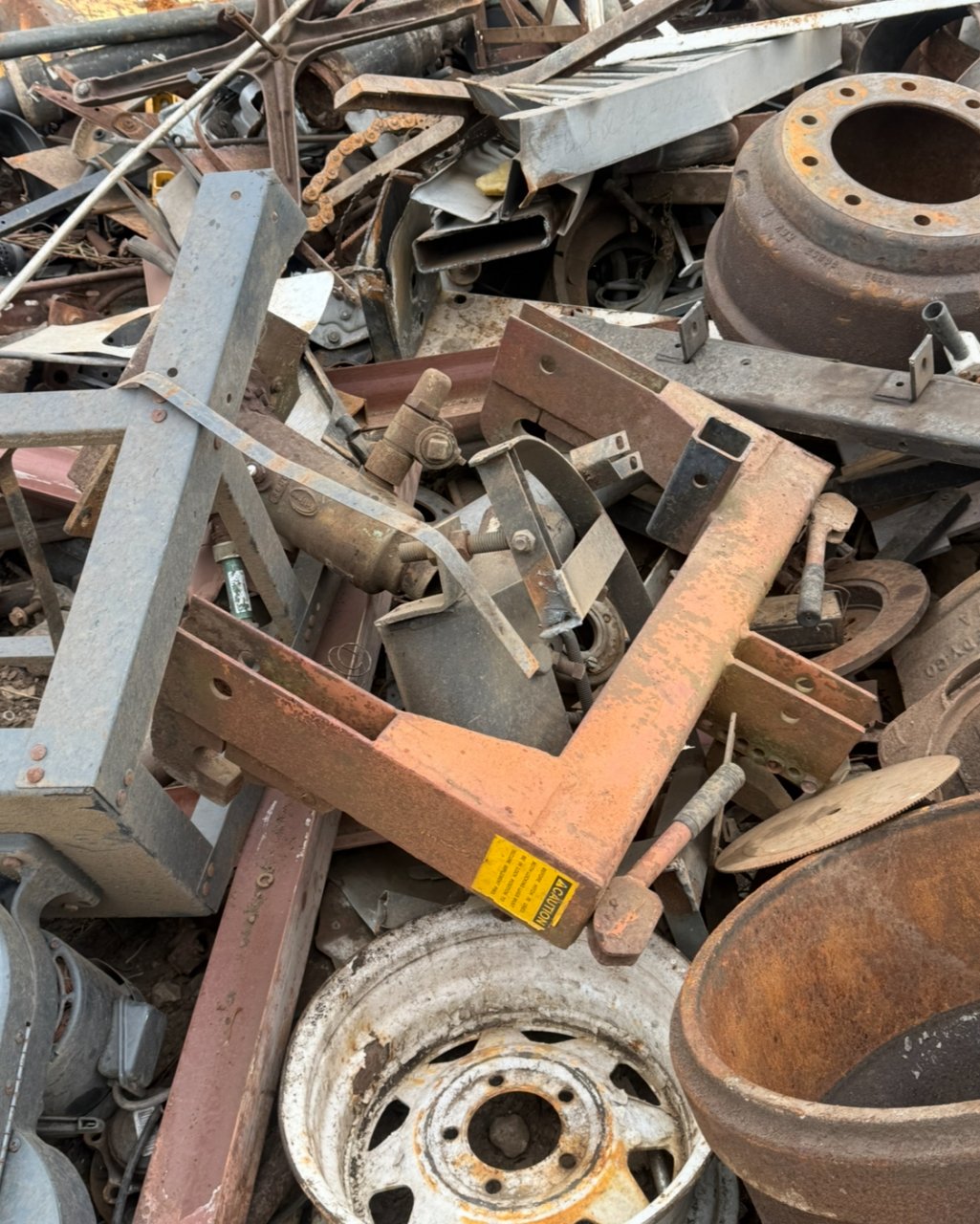

    Back down to the 49 again. Reloaded in WV and found a few treasures amongst the junk, or I mean stuff…..
