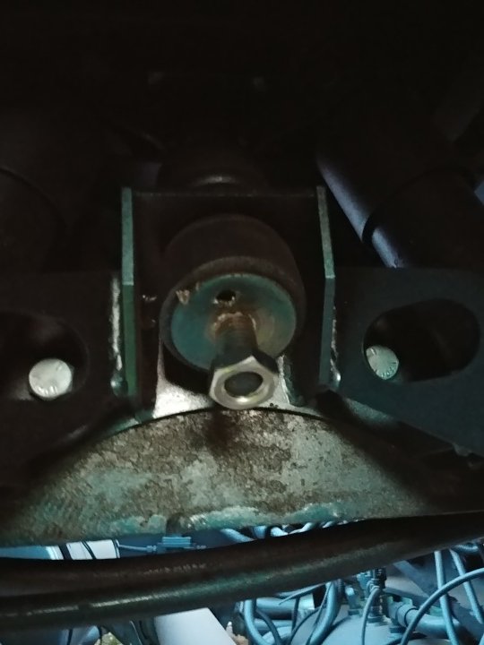

    LLMF
    First, are you trying to turn it the right way? It might be reverse threaded, and instructions have a bad habit of not instructing on that crucial detail when applicable.
    If that's not the problem, I would break out my 36" 1/2" drive breaker bar which usually does the trick. If you don't have one, you can put two wrenches together to get more torque.

  8. SAR
    SAR Road Train Member
    2,756
    36,654
    Nov 26, 2011
    ND
    I think what you got made there will work. Maybe put a impact on it with low power and see if it will rattle it loose.
    If that don't work I think your idea of welding a larger nut will be fine, just have a wet towel ready to cool it down. Good luck

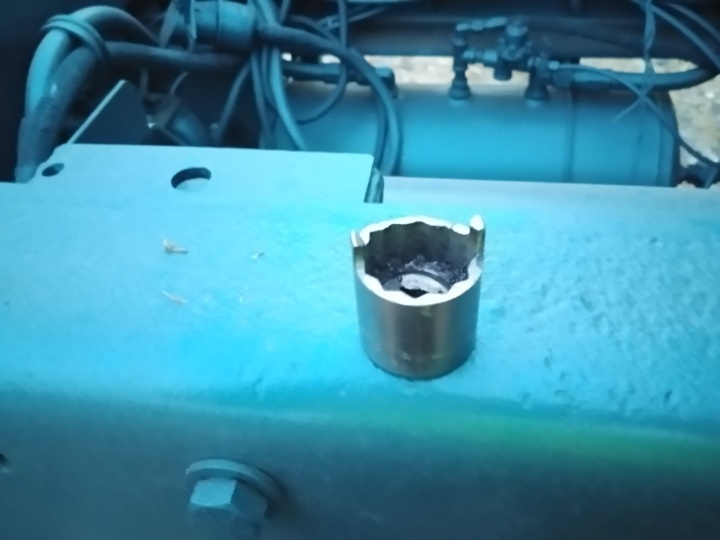

  10. Oxbow
    Oxbow Road Train Member
    13,774
    142,896
    Nov 24, 2015
    Well, the jam nut is right hand thread so I think the washer thing would have to be as well. Hopefully my homemade socket will do the trick. I have plenty of breaker bar if the socket will hold up.
