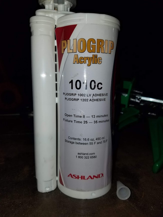

  11. Steve from hutch
    Steve from hutch Medium Load Member
    I talked with engineers at both the company that makes Metton and Ashland, they were very helpful about bonding. The stuff they suggested was shown below, this has a 10 minute window to work with, they have other formulas with up to 30 minute work time.
