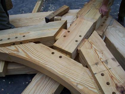

    They still do traditional post and beam construction, mortise and tenon joints, cut outs for other pieces to set in, etc. held together with oak dowel pins. The tension rods are a few-and-far-between item. This structure is about 100' x 160'. Think 3 story barn (60' x 160') with a shorter (20' x 160') lean to on each side.
    The plates on the pallets get epoxy anchored to the concrete floor, the ones with short pipe are for outside supports under the porch. The bottom of the post has a pocket in it that slides down over the tab welded to the plate. They drill through the bottom of the post and the steel tab and then drive the 1" steel pins in those holes. This gives uplift protection.
    All of the wood pieces are prefit and drilled in the shop for the oak dowels. This structure has been assembled once, in small units at the shop before it is sanded, oiled and sent out for the final raising.
    They use SIP screws for the roof and wall panels.
    I'm going to try to get over to watch the raising, since it's only about 60 miles away.
    timber2.jpg timber.jpg This is the type of joinery they do.
