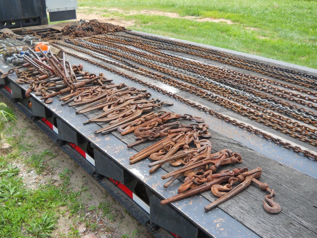

    When I retired,I cleaned my trailer out,and this is what I was carrying for securements. Just got carried away,didn't realize I had this much stuff hidden away. Those big American made snap binders were probably 50 years old,bought them when I first started.
