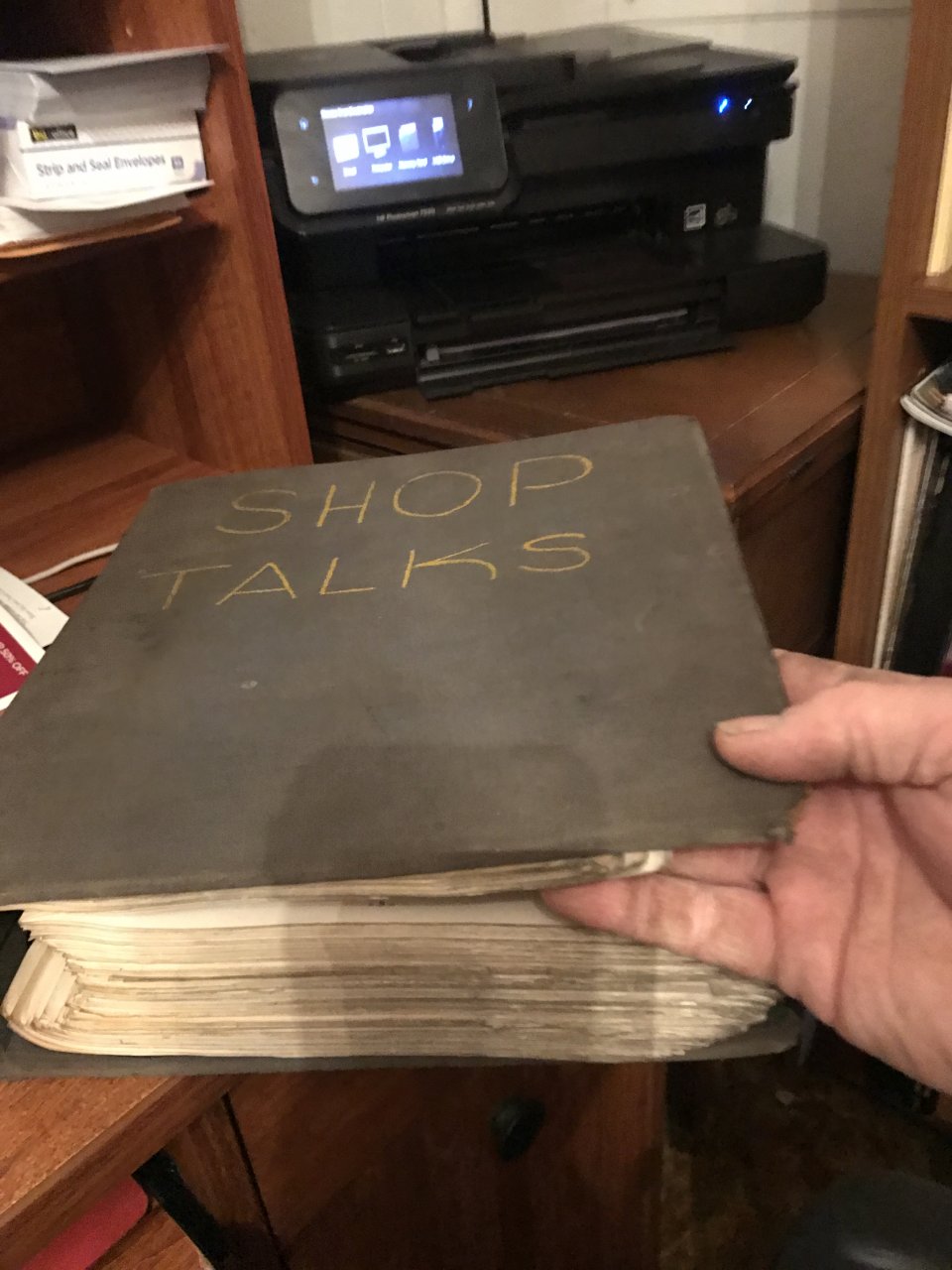

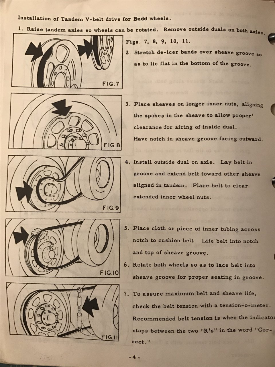

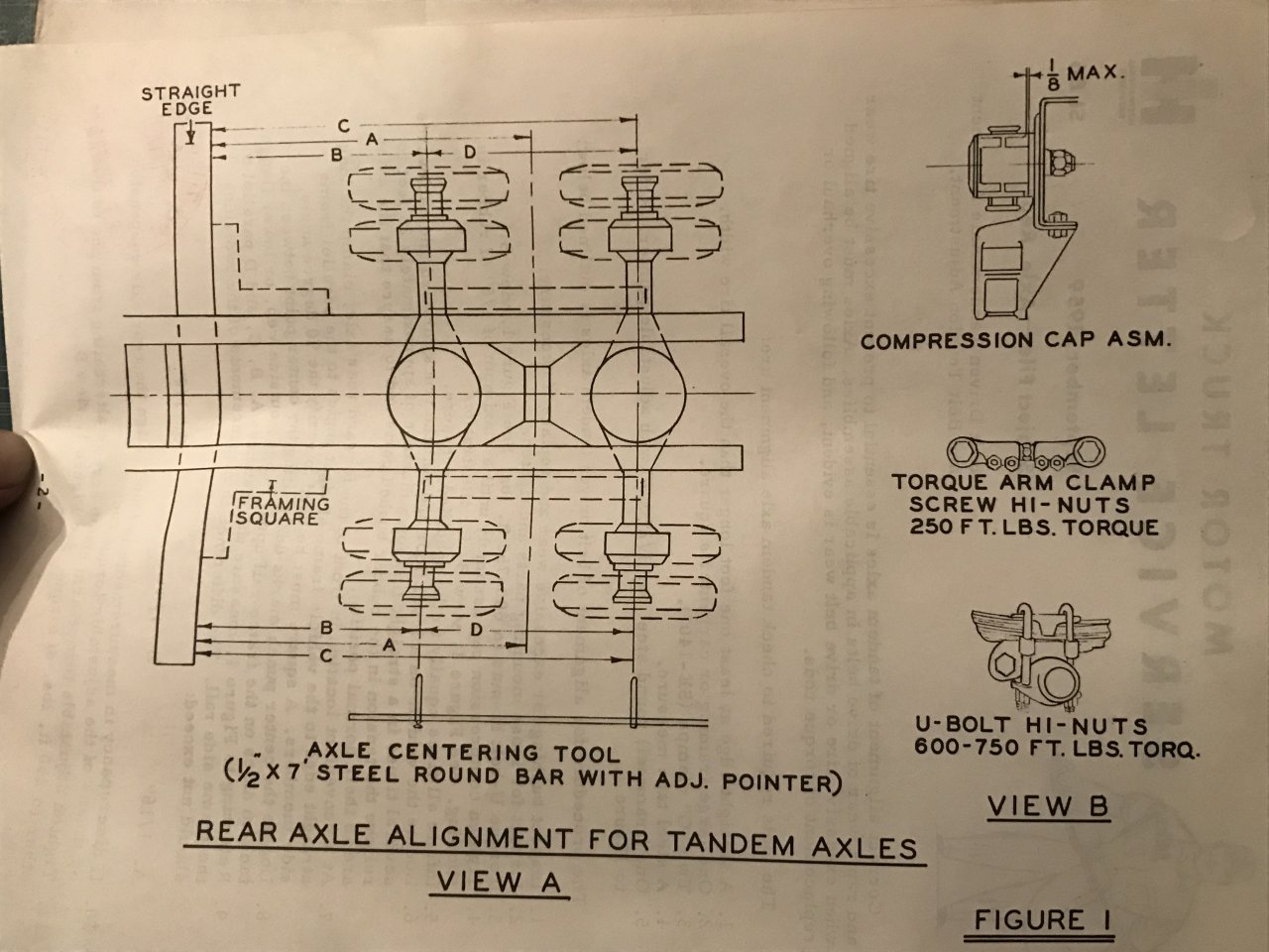

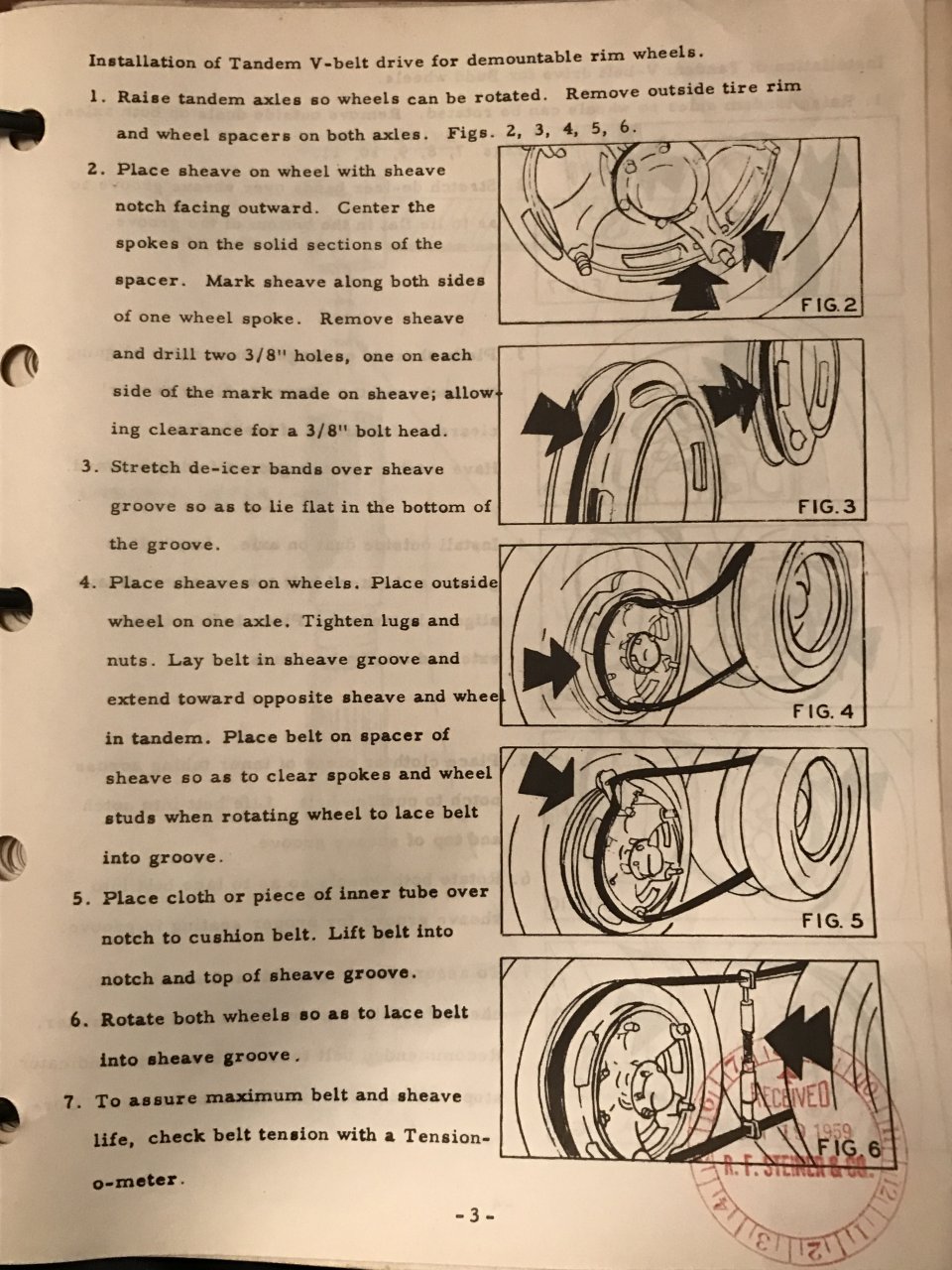

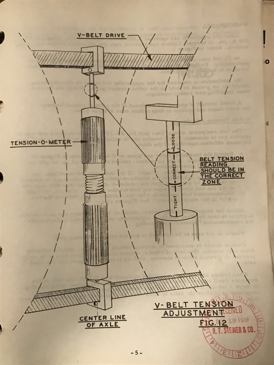

    IMG_8762.JPG IMG_8763.JPG IMG_8764.JPG IMG_8765.JPG IMG_8766.JPG IMG_8767.JPG IMG_8768.JPG IMG_8769.JPG IMG_8770.JPG Going through my library of info from years past and found something that may interest the younger viewers.... ??
    Many here know my dad retired from a International Harvester dealer after years of service, this is from a book given to me from the owner after the doors closed permanently.

    Lot of information in this book, from Scouts right up to our size every day toys.
