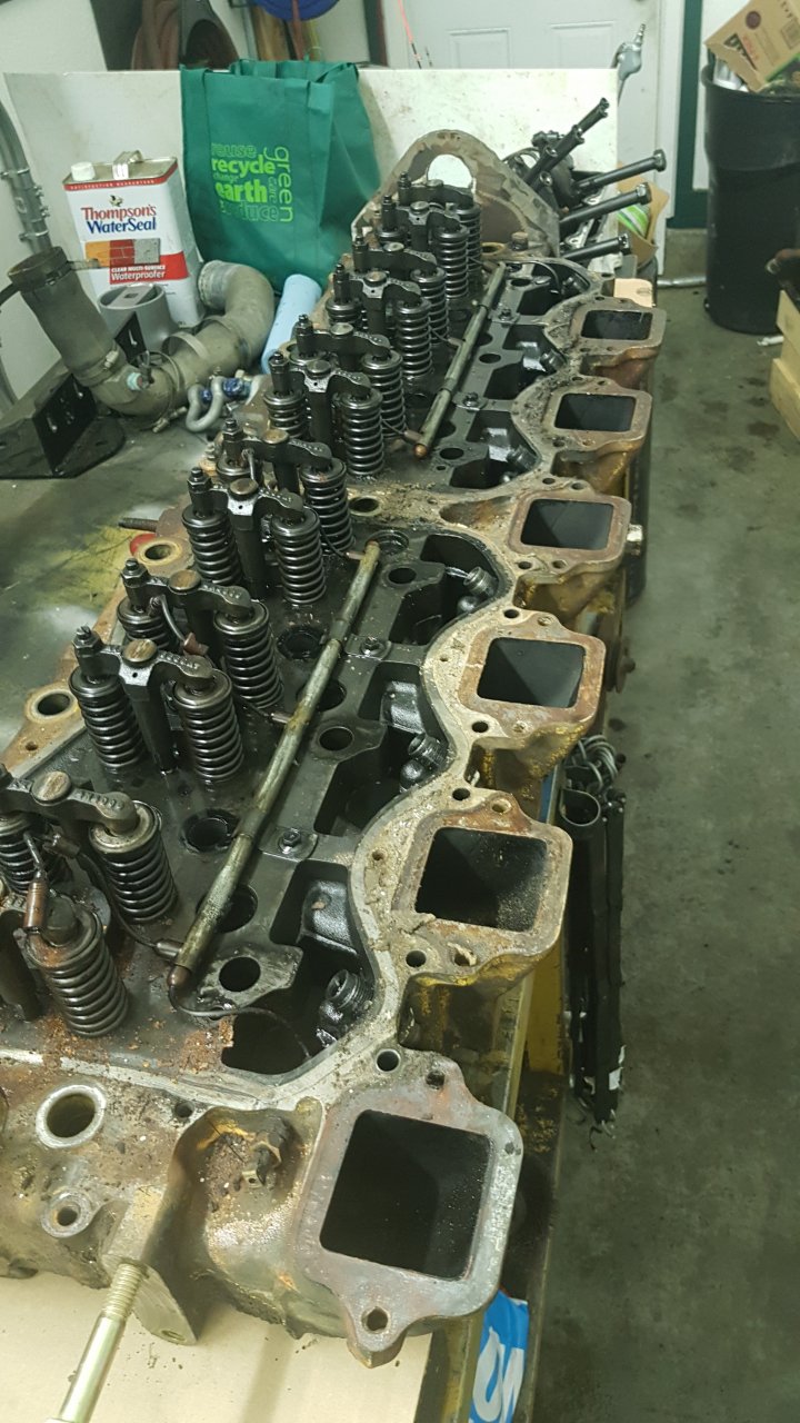

    Current situation at hand: 20181122_192153.jpg

    Cool. Head is off and looks to be in good shape?

    Hijack incoming! (again)
    Where do CAT heads normally crack? Anybody know of any products a guy can use to highlight the cracks? Heads aren't cheap and I'd like to re-use mine if possible since I might put 1,500 miles a year max on this engine.

    Don't see any visible cracks. All 6 pistons are cracked bad around the heat plugs. No crosshatch left on the pistons (assuming it had a few too many visits from the ether bunny). Looking at some of the patterns on the liners I'd wager its got a broken ring or 2. I'll find out later today. Hoping to get the piston assemblies out and front cover off by tonight.

    Between the valves.
