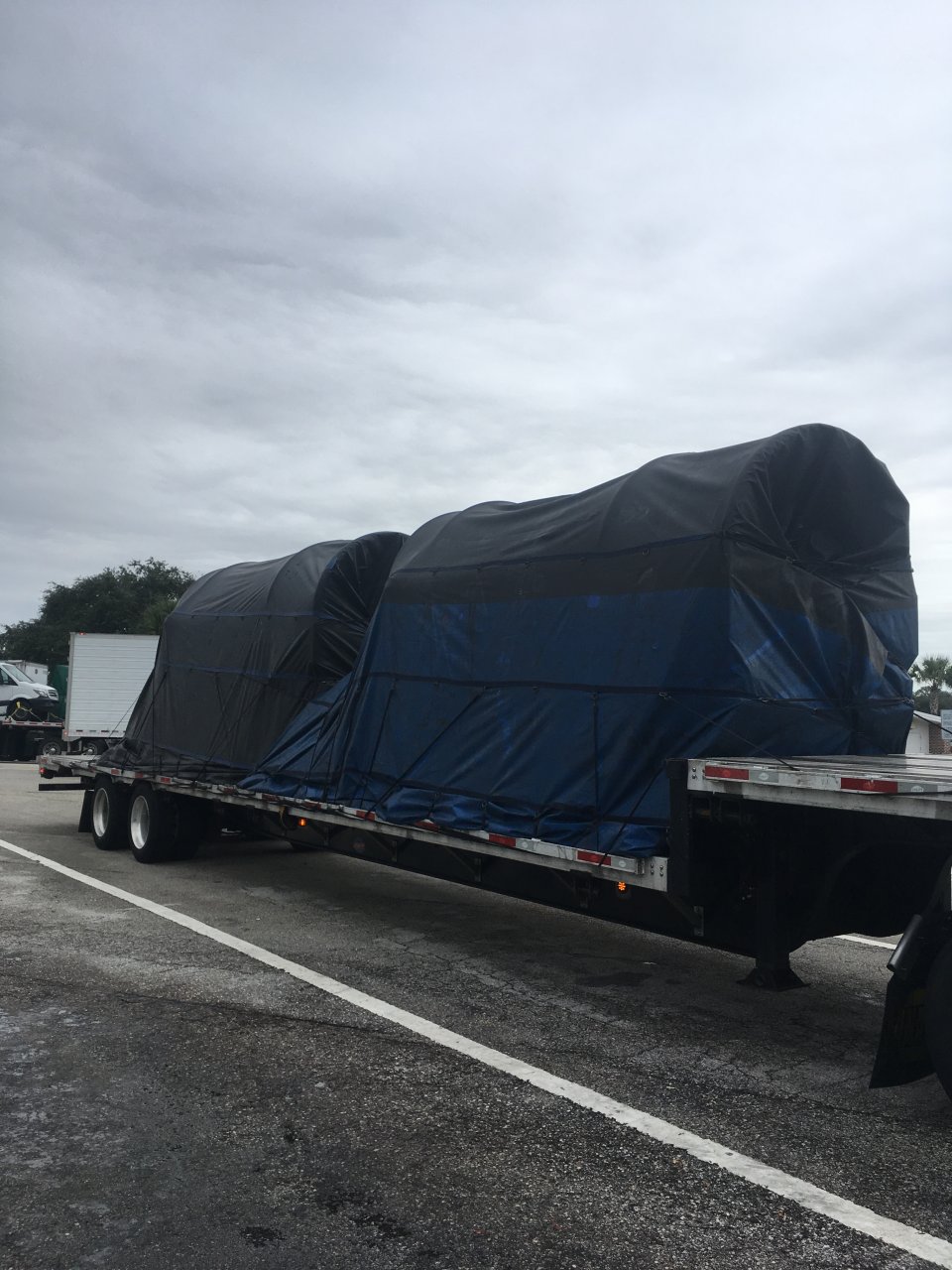

  9. stwik
    11,880
    168,415
    RV family comes over and asks me what I got under the tarps... two little kids with em so I decide to embelish a little bit...
    “Military Jet Engine trailers...”
    “Engine trailers, huh? I served for 20 years.”
    “F135 trailers per the bills, sir. Thank you for your service!”
    Kinda neat. Got a little bit of goof off time so decided to rework the tarp a bit... still looking like some sexy freight if I say so myself :cool:
