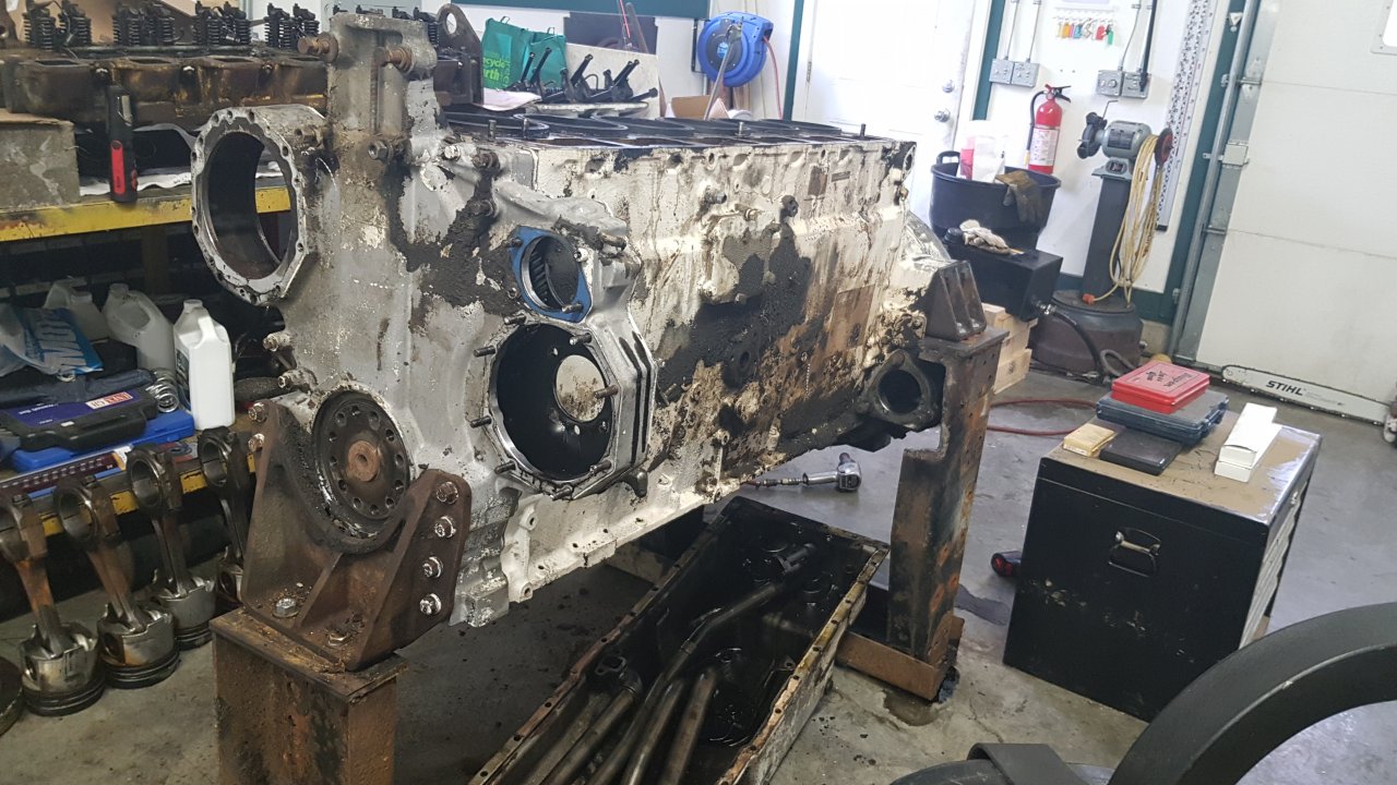

    Are you going to have the block decked and line bore the crank mains since you have it tore down that far ?

    Shame, other than the newer style bunk that is my dream truck.

    If I can find a place that does it I will definitely have it done.
  5. Just curious caN you magnaflux a block that big? Looking for cracks????

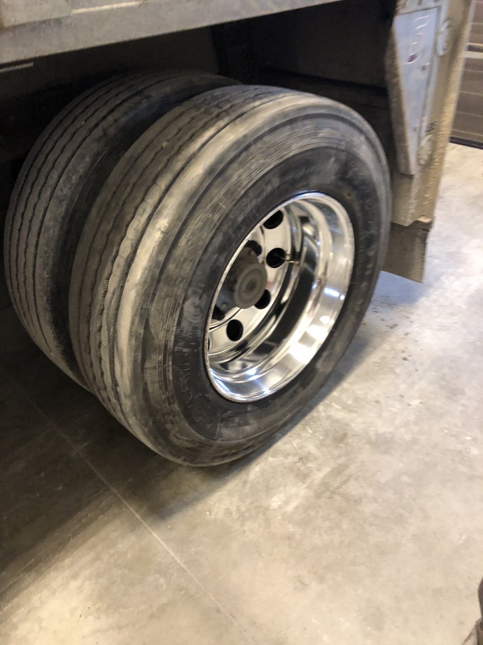

    Think I got the trailer part all fixed up? Still waiting on truck parts. 3849D29C-0F89-4782-BA07-68C4B23B5960.jpeg 5045E2FB-889A-4B9A-A1A5-B53E5546E910.jpeg 4D9C2D94-3536-42AF-8A98-A8A955693474.jpeg BD867C09-5DBD-4712-8104-65055D383E51.jpeg 861CE5A8-6FE9-4C56-B95E-69220AF0FE89.jpeg 65ADEEFC-CD82-4239-8747-2FAAB6B8A74A.jpeg

    Yes, and Sonic test. I had my Detroit head sonic checked for thickness. Warning do not mess with detroit intake side. Really close to water. Exhaust side smooth out, polish and port match. Its got Iron over there. Shoot I let a secret out.
