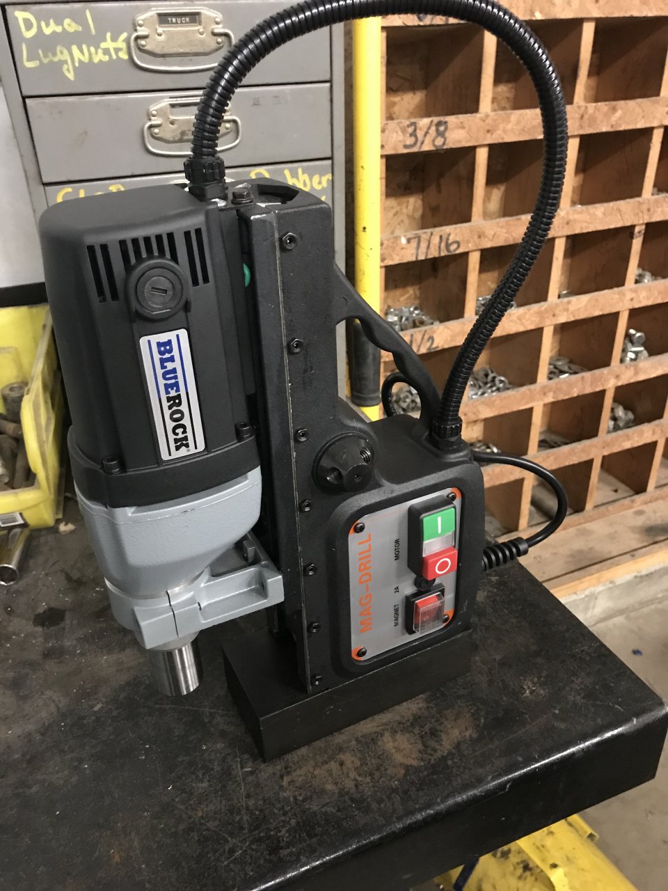

    Got a new toy in the mail this week. IMG_3217.JPG I only need to do a few holes. Looked at used ones for the last 6 months but they all looked like junk. I tried a couple of holes on the frame with a hand drill and that's just not going to work out. Believe it or not guys say these get the work done with a nice sharp bit?

    Reamer is the way to go. Drill a pilot hole and finish with a quality reamer.

    Set up with a 7/8" bit through a 3/8" pilot hole.
    Or, you can use annular cutters that make slugs like these. I drill a smaller pilot hole for the centering pin instead of using a punch mark to line up the more critical holes.

    I've never seen a mag drill by that name. I need to buy a quality set of center punches up through some big sizes. A center punch and my eyeballing aren't for accurate holes. My suspension swap is proof of fixing of center holes.
