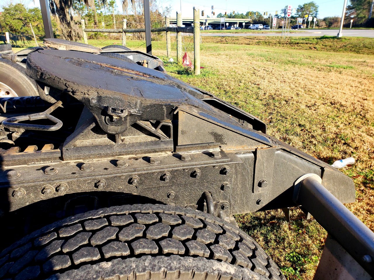

    We have a couple hydraulic but honestly, with the hassle of dealing with the motor, getting gas for it, dead battery so having to pull start it etc. I'll stick to mechanical. I will say that you can do a mechanical with a normal 5th wheel setup, I did for years however if you really want to make things much less work with one you need this-

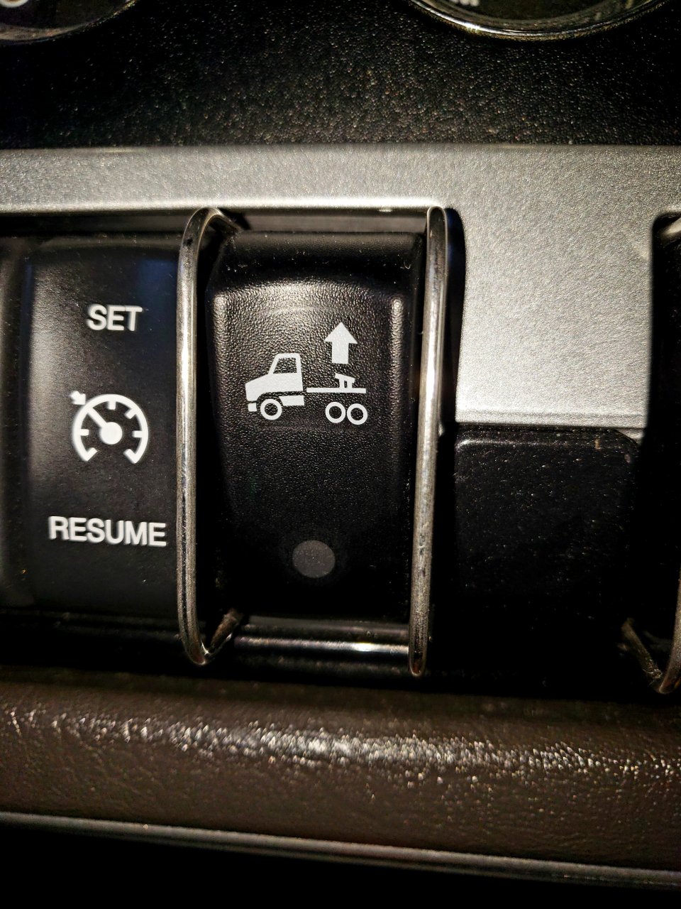

    If you think you might ground out with a mechanical you take it slow and if you do start to go to ground (high center) you flip this switch, BACK OUT, and go a different way.
    Knock on wood, I've been pulling RGN's off and on since I was a teenager at our farm and I have never got high centered to the point that I wasn't able to get myself out without outside help. And every time I have grounded it's been with a mechanical.
