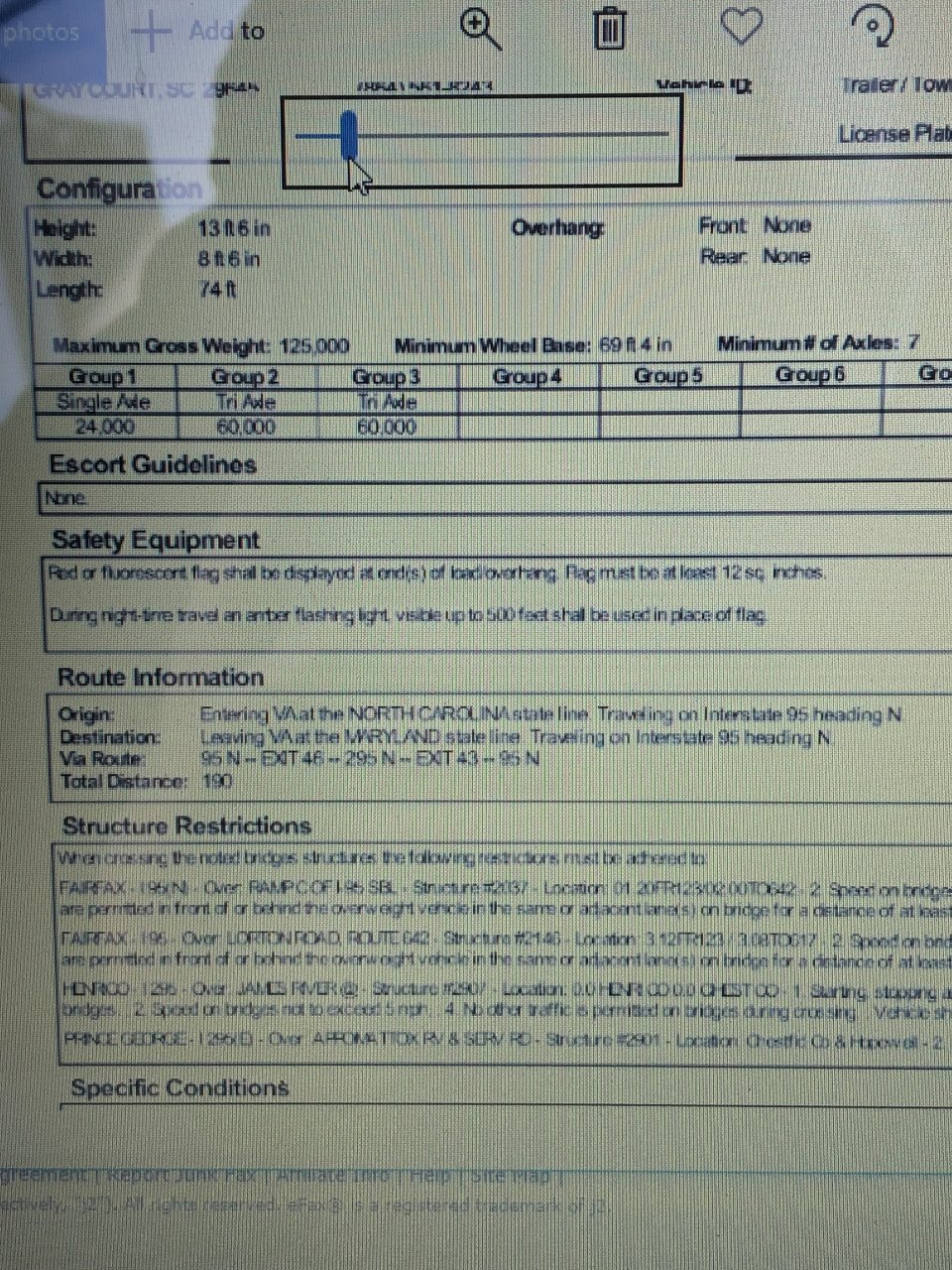

    The crawl restrictions have nothing to do with anything but weight. The escorts are to keep traffic back off the bridge.

    Yes, but you were not oversize. It don't make sense I know. Let me ask you this. All the times you had that did you ever slow down to 5 mph on an interstate bridge . If so your the first. What was your actual weight ? All I see is standard axle group weights that they issue regardless of what you requested. A certain gross weight group makes a difference. I do know anything over 140000 lbs. Is automatic of pilot cars on bridges. I don't remember if it is 120000 or 130000 where the requirement starts. I'm not where I can look it up.

    No I don’t slow to 5 mph. The actual wgt on the first is 131820. So I’m actually over gross by 1800 pounds. I permitted it just like the axle groups say. They generally just do like the second permit and just put max axle groups and a certain gross weight. I suspect it’s because one is delivering in state and one is going through the state. I will verify tomorrow, because I need to order a permit for 132k and I am just going to route it from tn to wv on 81. To get past the Roanoke scales. If I order to address it needs bridge approval and can take a couple days
