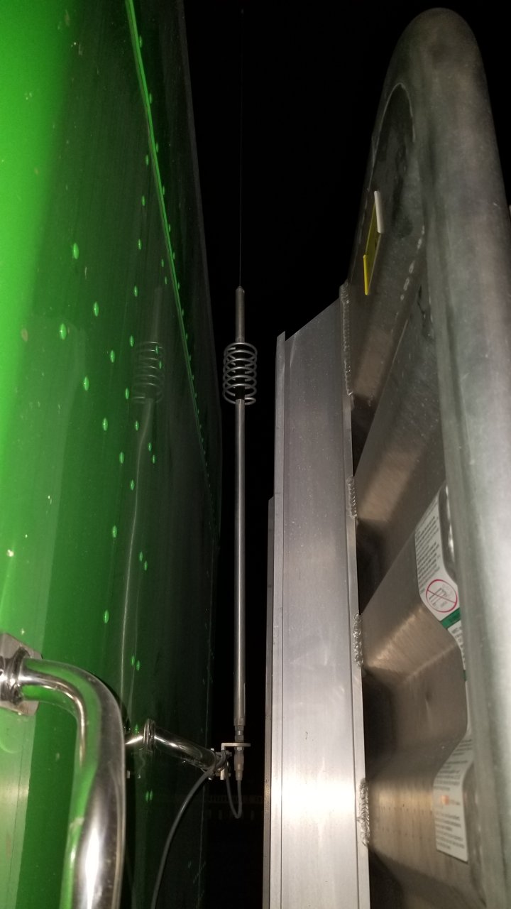

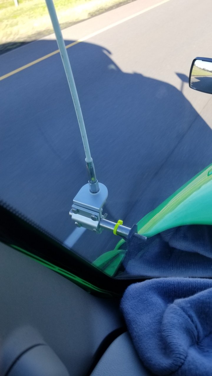

    You would benefit from a 6 foot antenna with a 20 degree tilt (skipshooter or the like) away from the body to lower your reflect. Check to make sure the bracket is grounded, that would be a big improvement.

    Oct 25, 2018
    Theres a big antenna behind the sleeper that was on here when I got it but it was giving me ant fail readings plus it was between the sleeper and headache rack. I'll put a ground on and tilt it forward and see how it looks then may try the big antenna. 20181114_185438.jpg
    Just running a stock uniden bearcat 880.

  7. shogun
    shogun Road Train Member
    6,075
    72,164
    Jan 23, 2009
    Doing a regen
    That’s an awesome antenna, a predator 10K with what looks like a 27 inch shaft. It’s not in the ideal location and that grab handle isn’t grounded due to paint behind it. That’s a great antenna for a pickup truck though. The coil needs to be above the cab. If it wasn’t too tall overall, it might work on your mount by the door.
    Don’t get rid of that Predator, it’s a lifetime antenna. You can buy replacement parts, it just threads together.
