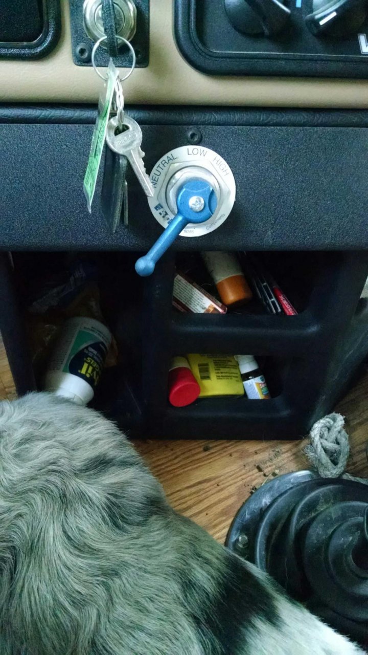

    I think your right. Air shift I believe? Could be wrong on that part.

    Yep it is, little lever on the lower part of the dash.

    Thought about putting in an 18 in place of my 13 when it goes out. Pretty easy conversion? The low range split would be nice.

    I have heard it described the same way. Seems like asking for trouble to me though.
