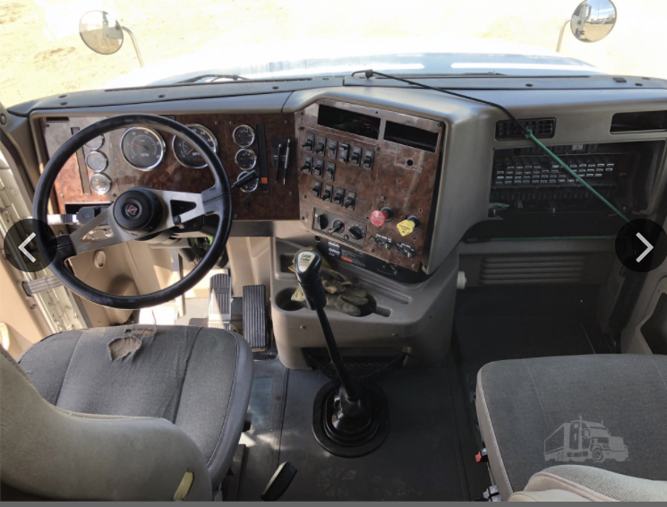

  4. johndeere4020
    8,522
    119,292
    Jan 1, 2010
    Yeah it makes a sense, I’m guessing the 9370 dash was closer to the 4300’s? My 98 9400 and my 95 9200 were like Tugs.
  5. stwik
    11,738
    166,692
    Well crap why did they build an International then?
  6. Humblepie
    Humblepie Pontificator
    5,077
    80,318
    Dec 25, 2018
    The HX international is the replacement for the 5900. That is the vocational version of the 9900. They quit making the 5900 a few years back. I’m pretty sure you can still buy a 9900. The hx is only available as a day cab of with the 51” sleeper. They are nice, and I would strongly consider buying one.
  7. johndeere4020
    8,522
    119,292
    Jan 1, 2010
    Yeah but you’re weird.

    (Edit) the older ones with the i model cabs like @Tug Toy and pre i model cabs.

    Look im not pro Intettrational! But them older cabs like tugs were very well built.
