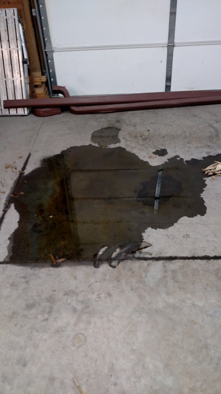

    The puddle that was under my skiddy.... Haven't got that one figured out either. They are not fun to work on.
    Crusader66, Oxbow, cke and 6 others Thank this.
  8. 1951 ford
    1951 ford Road Train Member
    3,008
    61,227
    Feb 23, 2016
    Goddard, KS
    No, they're not.
