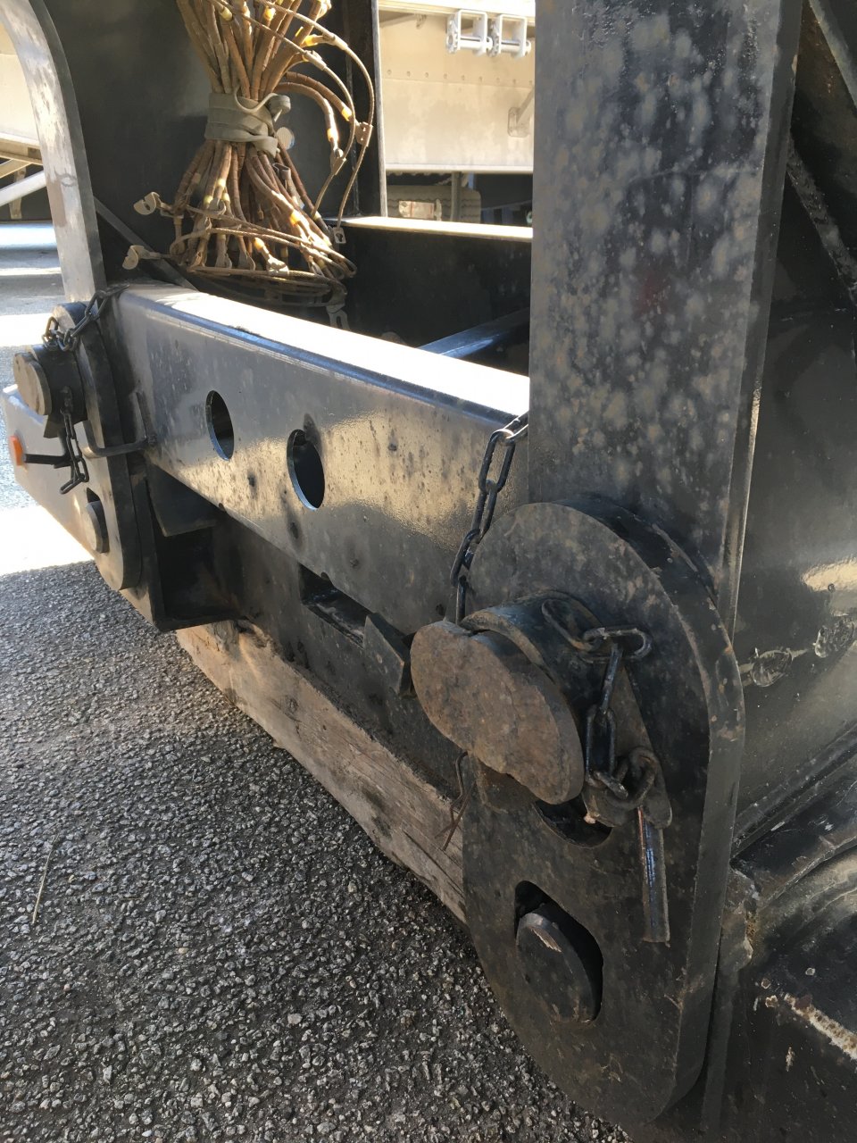

    It’s easy! Just holler when you are ready. There are at least 3 or 4 of us well aquatinted with a mechanical detach Fontaine

    I see that’s not a Fontaine, but it’s the same principle

    Set trailer brakes. Detach air lines from neck. And then uhhhhh...
    What comes off?

    Pull fifth wheel, pull out from underneath, disconnect lines from neck, flip up dog bones, back back under it, pull the pin on neck, block neck with board across frame rails, raise air bags, pull out. And do that in reverse to hook back up

    You will forget the air lines at least once and you will forget the board at least once and you will drop the neck at least once. We all do, kinda like a rite of passage

    Oh @stwik make sure you are as level as you can be when you detach. Oak board is better than pine. Do you have frame ramps

    You lost me at pull fifth wheel.
    What?

    Ok, first question do you have ramps on the truck? Or is it bare frame rails?
