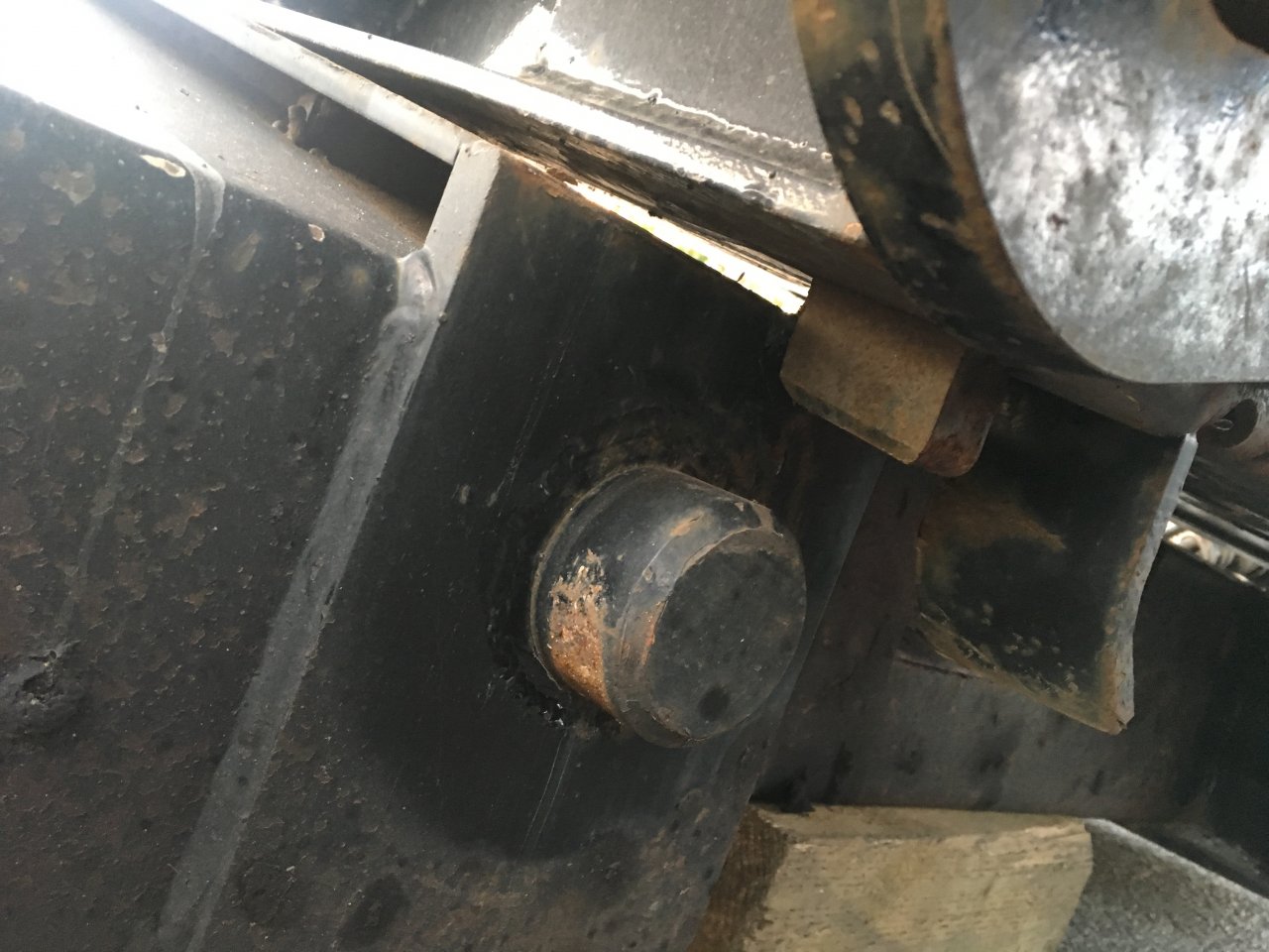

    Tug Toy, BigBob410, Al. Roper and 11 others Thank this.

    Oct 25, 2018
    Its ugly but it's on there
