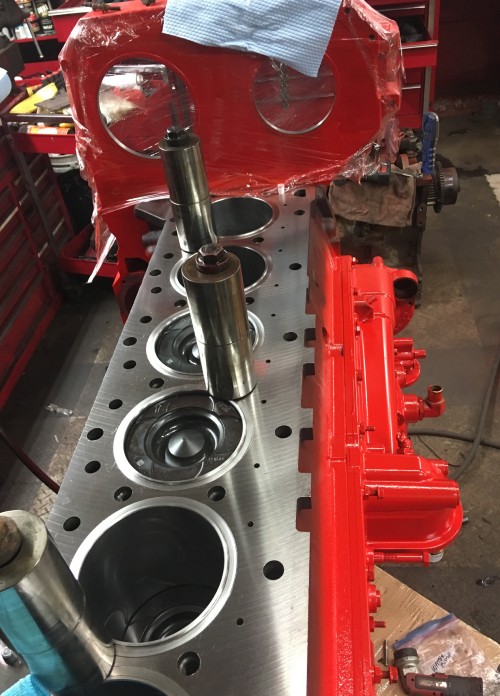

    Just tryin to buy some time at this point. We are busy right now and I need to be running.
    Found another N14 locally I can buy cheap. If I can get this one to get me by for a while, I’ll strip that other one down and have the block decked, counterbores cut, align bored, etc. then build it back up in spare time. That way it’s ready to go when needed.

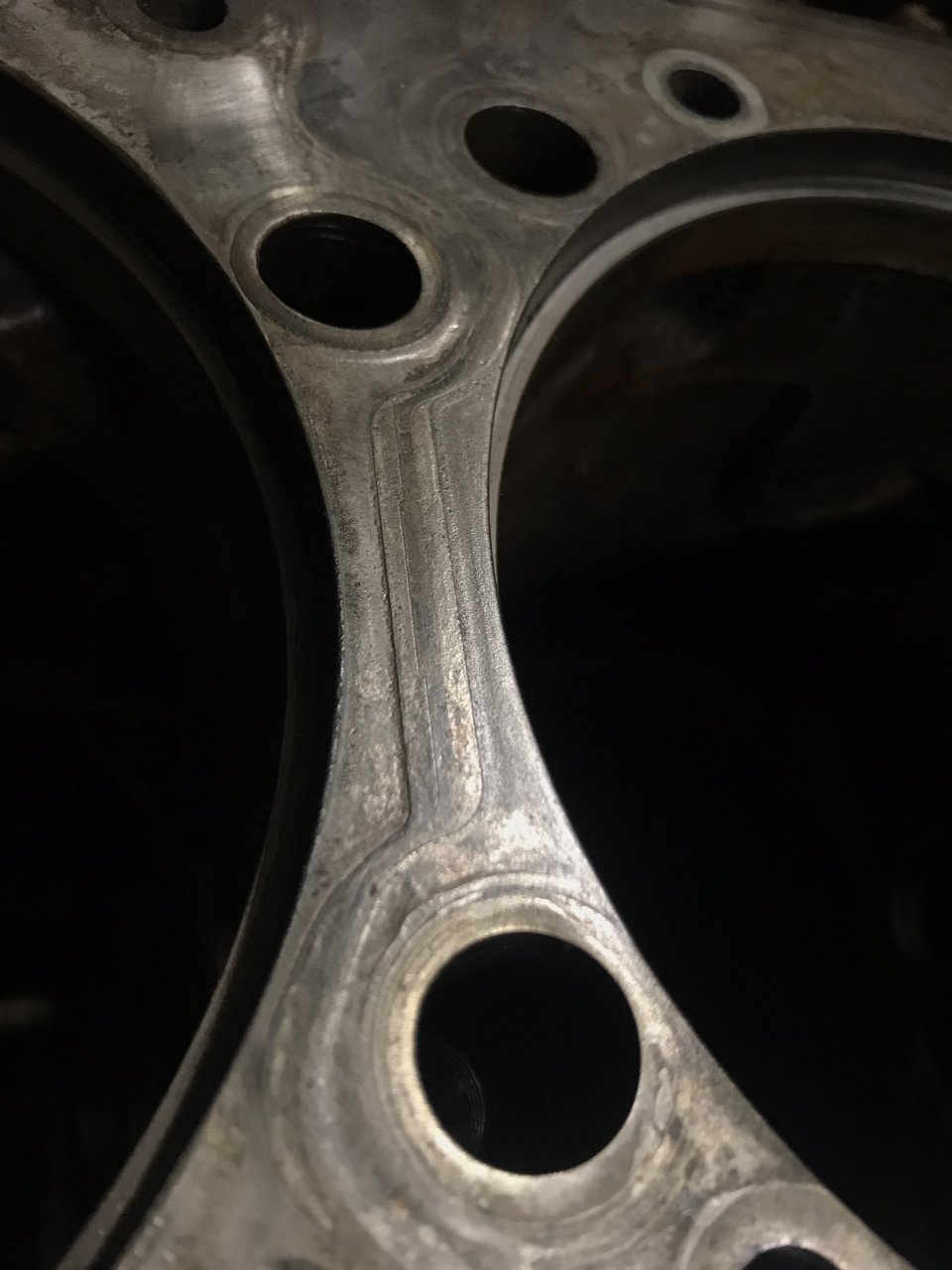

  4. ShooterK2

    It’s far from perfect but most of the bad stuff is between the heads

    I haven’t been leaking coolant at all. Just leaking compression to the outside. Had a loud chirp when on the throttle. No broken head bolts, just low liners not sealing up.
