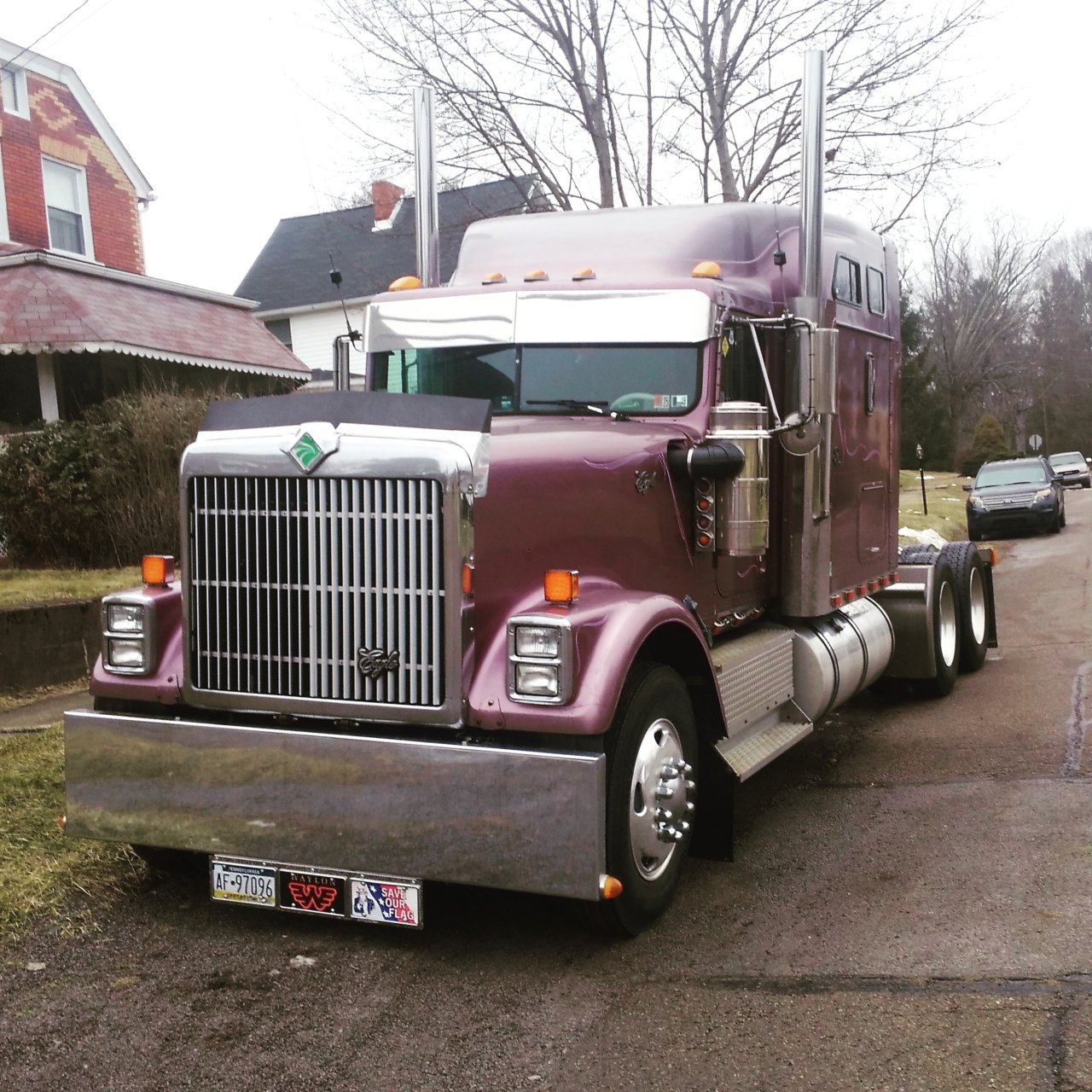

    I like that visor. I had not seen that style for a 9300. Where in the world did you get that???? Looks good!

    You’re large car still gettin down the road alright? You don’t post enough pics of that rig....
