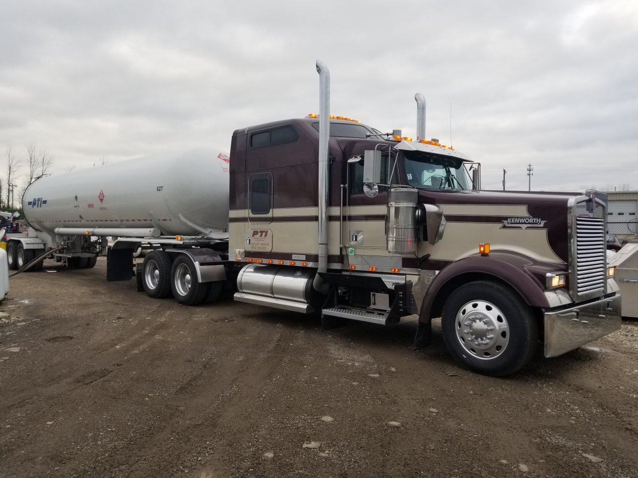

    Thinking about buying another one....sometimes more is better.

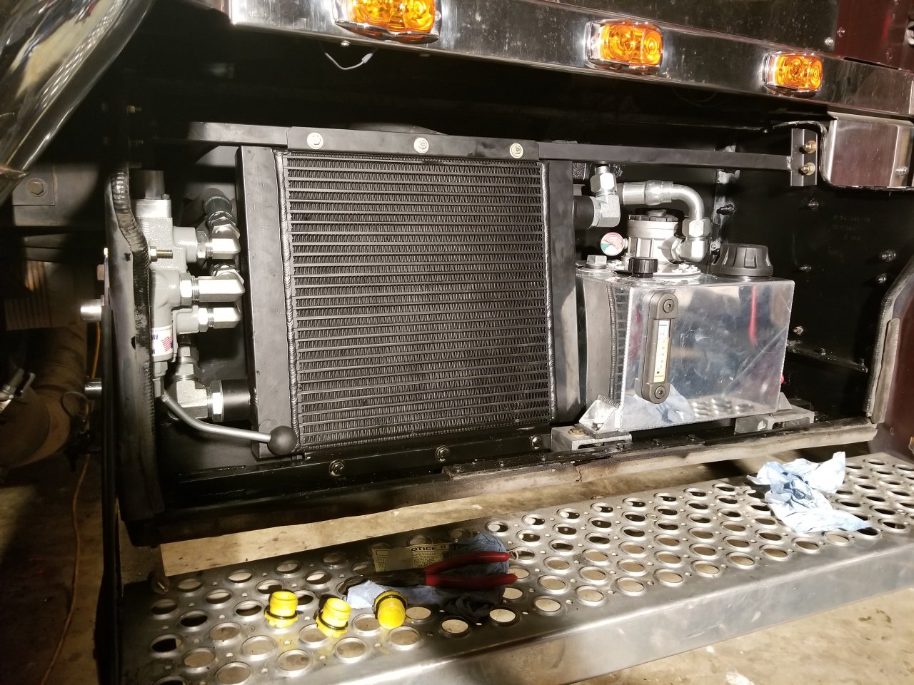

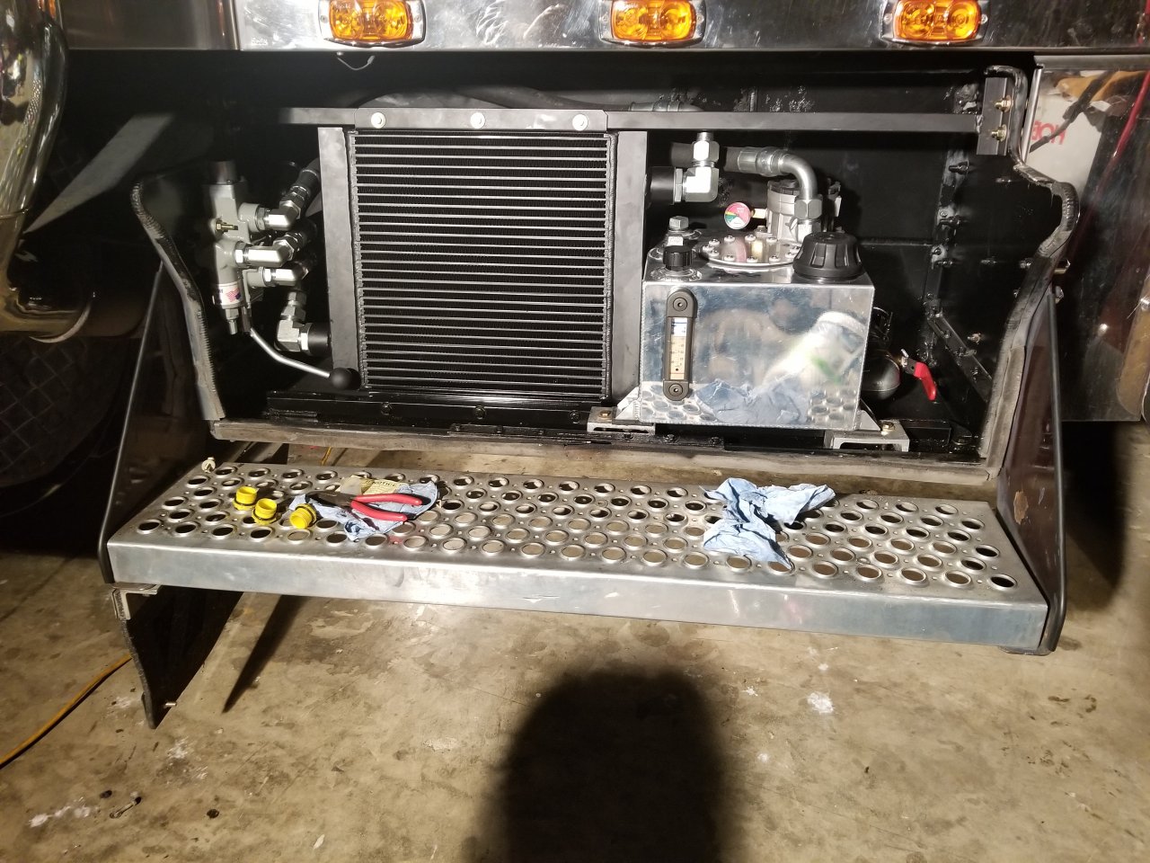

    That's genius. I might have to borrow that idea one day.
    Would you say it makes unloading more difficult? or no change?
  7. snowman_w900
    4,418
    81,025
    Nov 25, 2010
    No change bud. Unloads just as good as any hydrapak. It's a 5 gallon reservoir with the biggest hydraulic cooler I could find to fit in the toolbox. I went with 3/4" pressure, and 1 " return and it flows real well.
    I think i had about $1000 altogether in parts versus a hydrapak cooler at $4000. I also like the electric fan better than the hydraulic fan on a hydrapak cooler because I can turn the electric fan off or on in the winter. The hydraulic oil warms up faster and not so much cavitation in the hydraulic pump. Seems to be easier on things.
