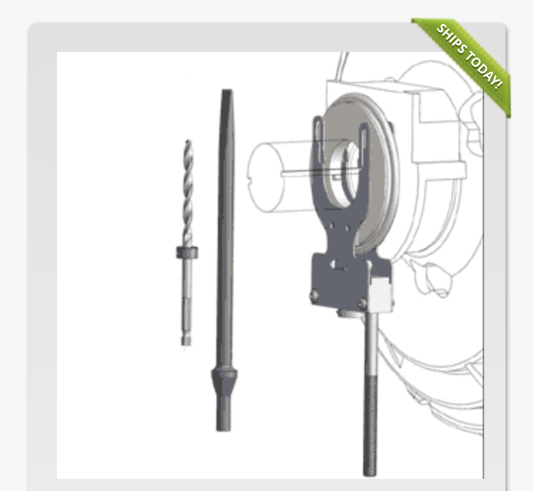

    If yer looking for a better clutch brake get an Ace B201. Snaps together and requires no tools or pins or screws. Remove with a twist of a screwdriver. I put one in a year ago and no complaints.

    My trouble is always getting my old one out. Out in the open free handed I'm salty with a torch. But in that hole I worry about all the places that fire is goin and can't get it done. I have tried a air hammer which sucked. Used to some of them old versatile tractors you couldn't get the brake distance and clutch free play right. We learned to cheat and use 2 brakes and it seemed to work well. So I'm kinda thinking about trying that. The snap together one may be just right for that approach

    I'd be paranoid about using the torch in there too. My luck I'd probably #### the release bearing or melt a clutch spring or 3. My first week wrenching I managed to wreck the heavy brake shoe return spring while trying to heat a seized dust cover bolt. Worst part was it was on a log trailer loaded onto the truck so we couldn't just yank the tire and replace it either.

    Here’s the ticket
    Kiene Diesel Tools - Kiene Clutch Brake Cutter
    A better description of how it works.
    Clutch Brake Cutting Tool, K-1360, Kiene Diesel
