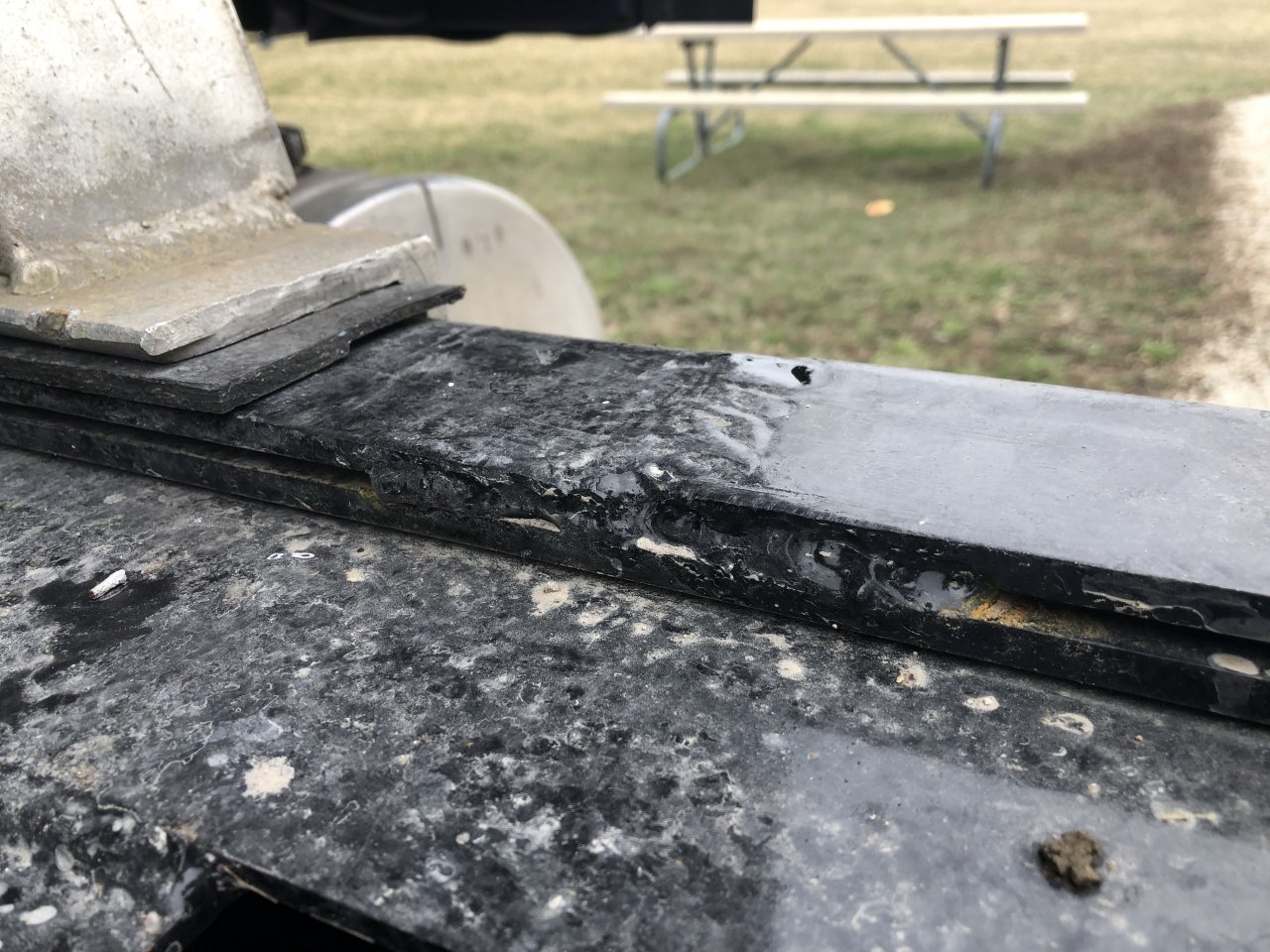

    Holy cow!
    I dont like to dog a mans ride, but those guys did a horrible job on that thing. That's just askin for trouble in my opinion
    Slowpoke KW, cke, Czar_Zero and 23 others Thank this.

    Wow!!!! Straight edge??? We don't need no stinking straight edge.
    Slowpoke KW, cke, 7-UP and 19 others Thank this.

    How could anyone let that out of their shop?
    Slowpoke KW, cke, 7-UP and 20 others Thank this.

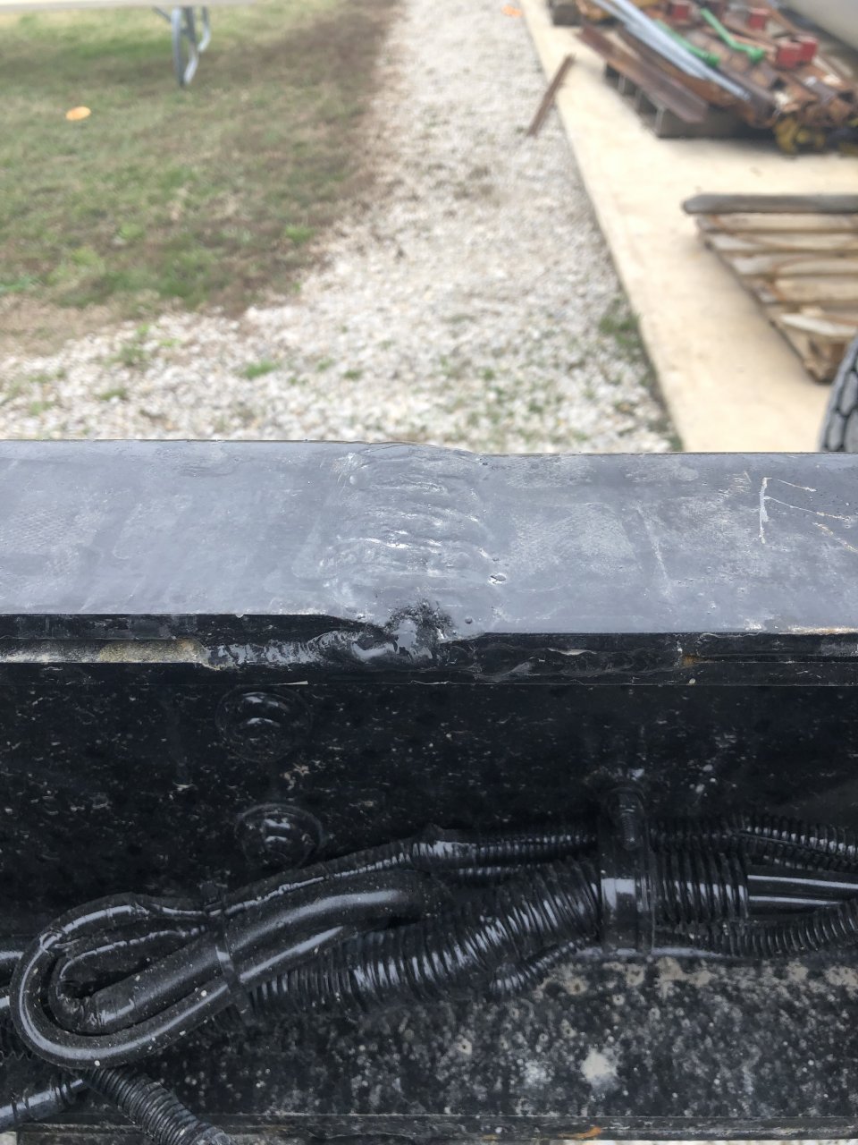

    I used a needle scaler as well initially. Then a cup brush on a grinder, and a small air grinder with a 2” wire brush for tight spots. Still there and no problems.
    @ShooterK2 when I took the bolts out of my 5th wheel frame, some of the bolts cracked like a shotgun..... I’ve said it before and I’ll say it again, rust has the strength of hydraulics! Be surprised how it will stretch a bolt.

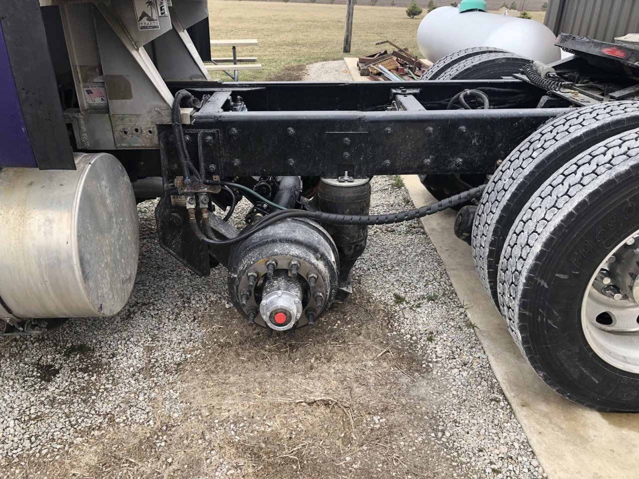

    Not the best pic but that's when we picked up a W9 we turned into a daycab from the blasters. We didn't pull the plate offa that'n cause it werent too bad. 20180830_113345.jpg

    Man I dont know. I'd really hate to see what an engine overhaul they did looks like

    Looks like a tragedy looking for a place to be sued for.

    We pull em off the rails an he tapes em up real good. Done probably ten trucks so far an aint had nary a problem with one yet.
