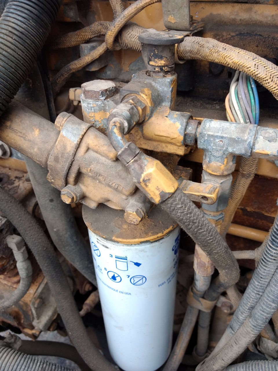

  5. wore out
    wore out Numbered Classic
    17,584
    219,906
    Jun 5, 2013
    CHASIN THE DEVIL'S HERD
    Looks like a air bleed line on a dozer. Dont take that for the gospel
  6. OLDSKOOLERnWV
    19,322
    292,047
    Naw just had check make sure “somebody” was still alive.... :D
  7. OLDSKOOLERnWV
    19,322
    292,047
    Ain’t that the primer pump to the left? Most 3208’s has a small valve on top the pump with a line going down by the front side of the block. Crack the valve and work the primer till fuel came out the hose onto the ground, close the valve then crack the injector lines and continue priming. Once solid fuel came out, tighten the injector lines (at the injectors) and start the engine. My old D2 Cat dozer was real similar.
