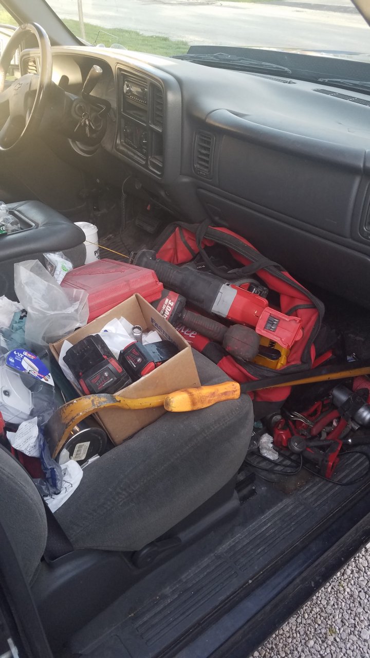

    Hey @Grubby , I've got her talked into riding up on the back deck of the trailer. If I can scale her on 5 axles , I'll bring her to you!
    Al. Roper, sawmill, 7-UP and 16 others Thank this.
  8. snowman_w900
    4,418
    81,025
    Nov 25, 2010
    I've got those same Matco pry bars. Suckers are tough as hell
