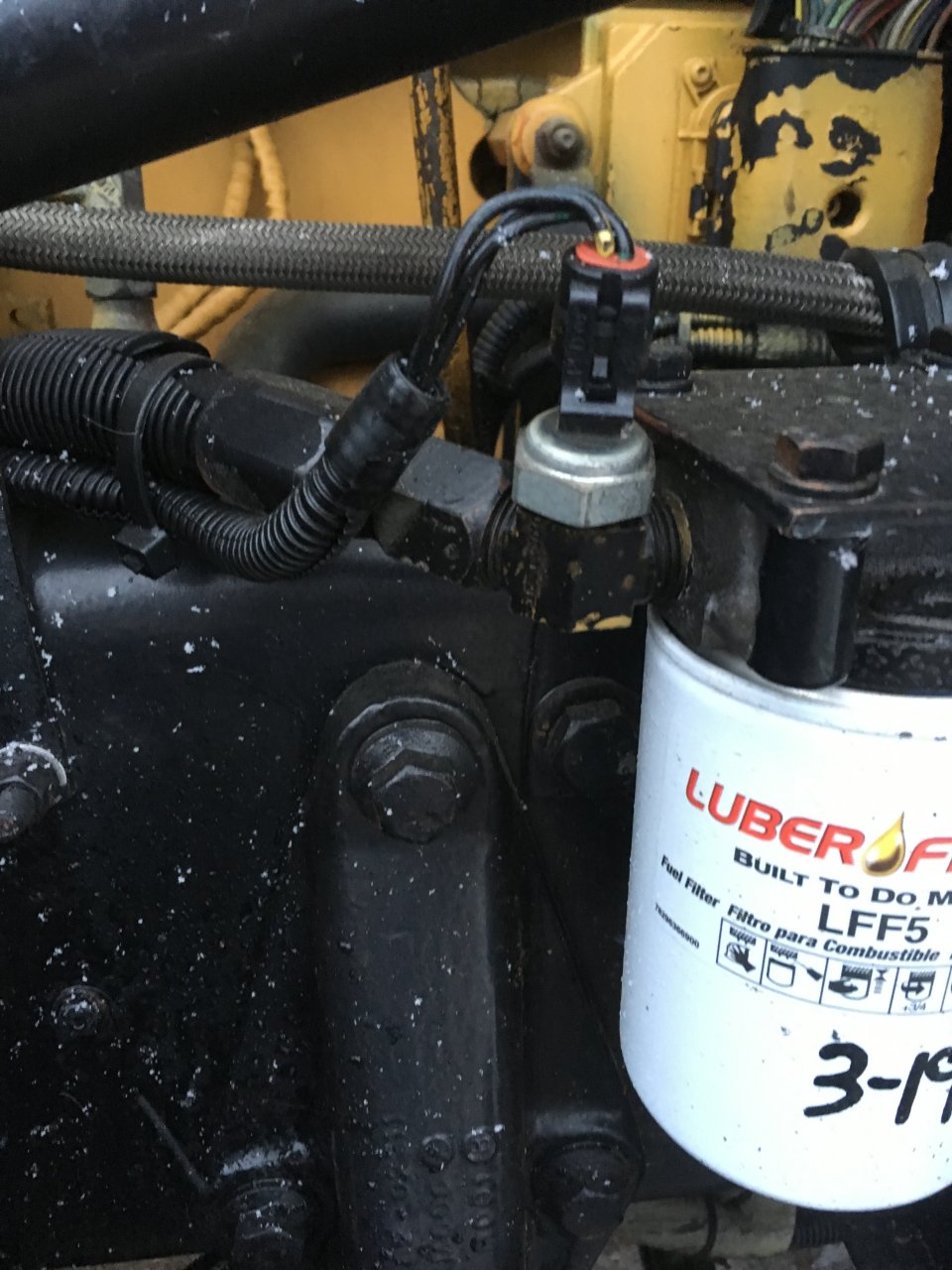

    In the draw line after the first filter.

    Ok, so electric pump sucking out of the tank to the low pressure pump on the engine and passing through a regulator before it gets there, the regulator returns extra fuel to the tank and keeps a steady clean fuel supply to the pump? That’s the gist of it?

    That's it

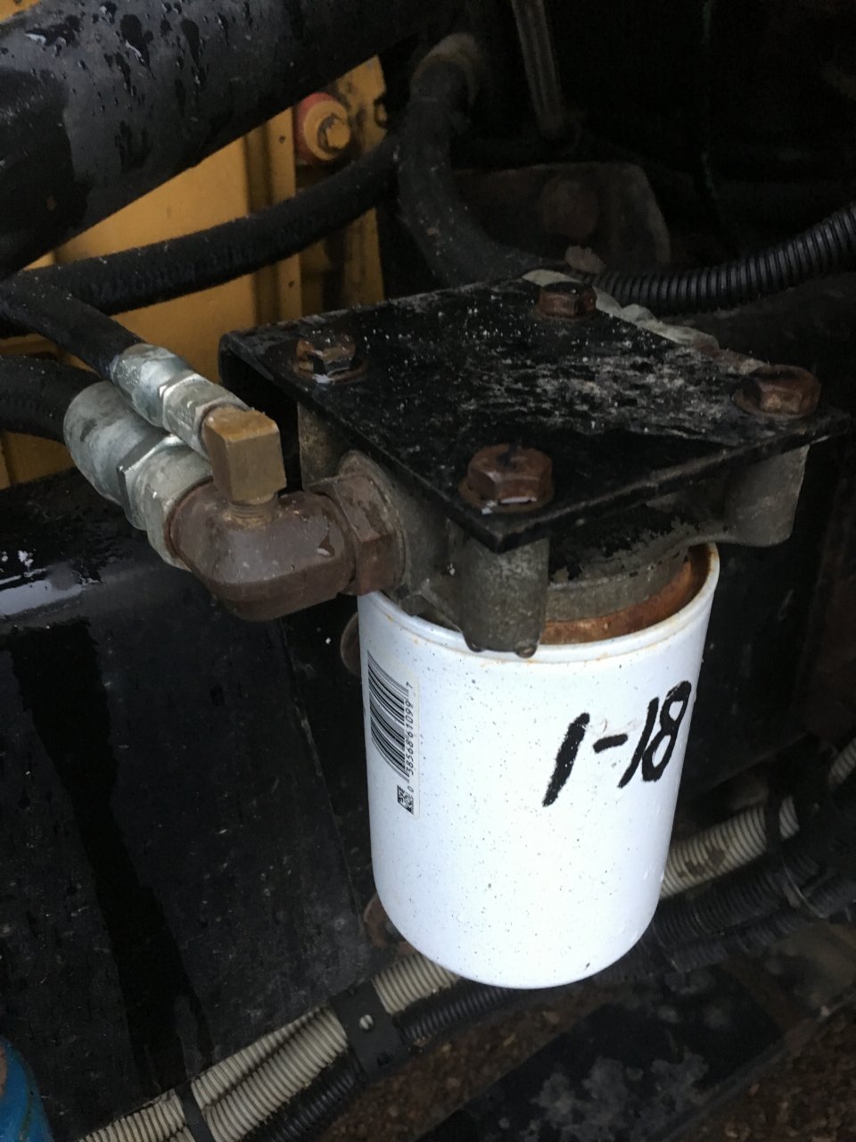

    So the commercial FASS units have filters on them, is that just extra filtration?

    From what I gather yes
