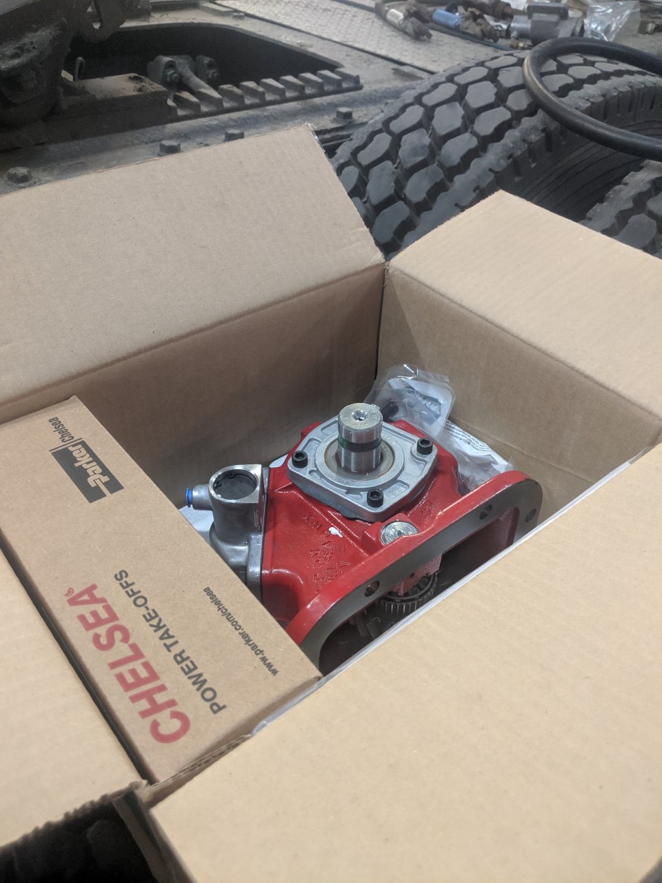

    I apologize for being nosy, but what did that pump cost? I sold a used one a couple of weeks ago for $750 and that was hose and tank and the whole enchilada. I say I sold it, the pos still hasn't paid me yet. Curious what they go for new up there.

    The compressor is $1100, comes with Ingersoll Rand SS5 compressor, flange on shaft, fittings for installation, and intake filter and housing.
    PTO was $575. Came with mounting bolts and studs, in-cab switch, air tubing and wiring for light.

    I had to relocate his air tanks so the compressor could be directly inline with the PTO. Driveshaft will be about 51" long and will have a slip yoke in it. The bracket that the compressor sits on is 1/2" plate. It's just sandwich clamped to the frame so we don't have to drill any holes in his frame. IMG_20190516_181440.jpg
