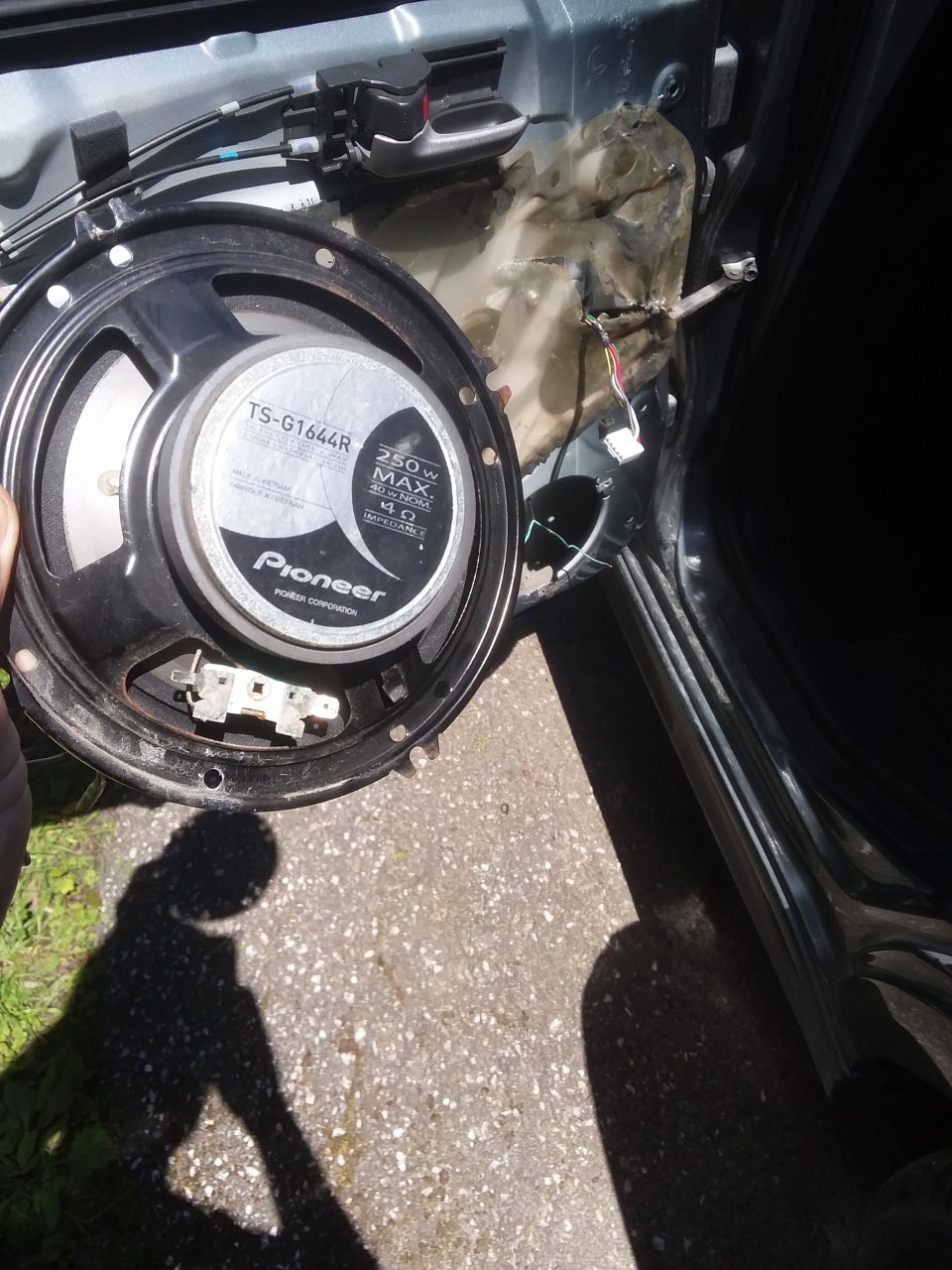

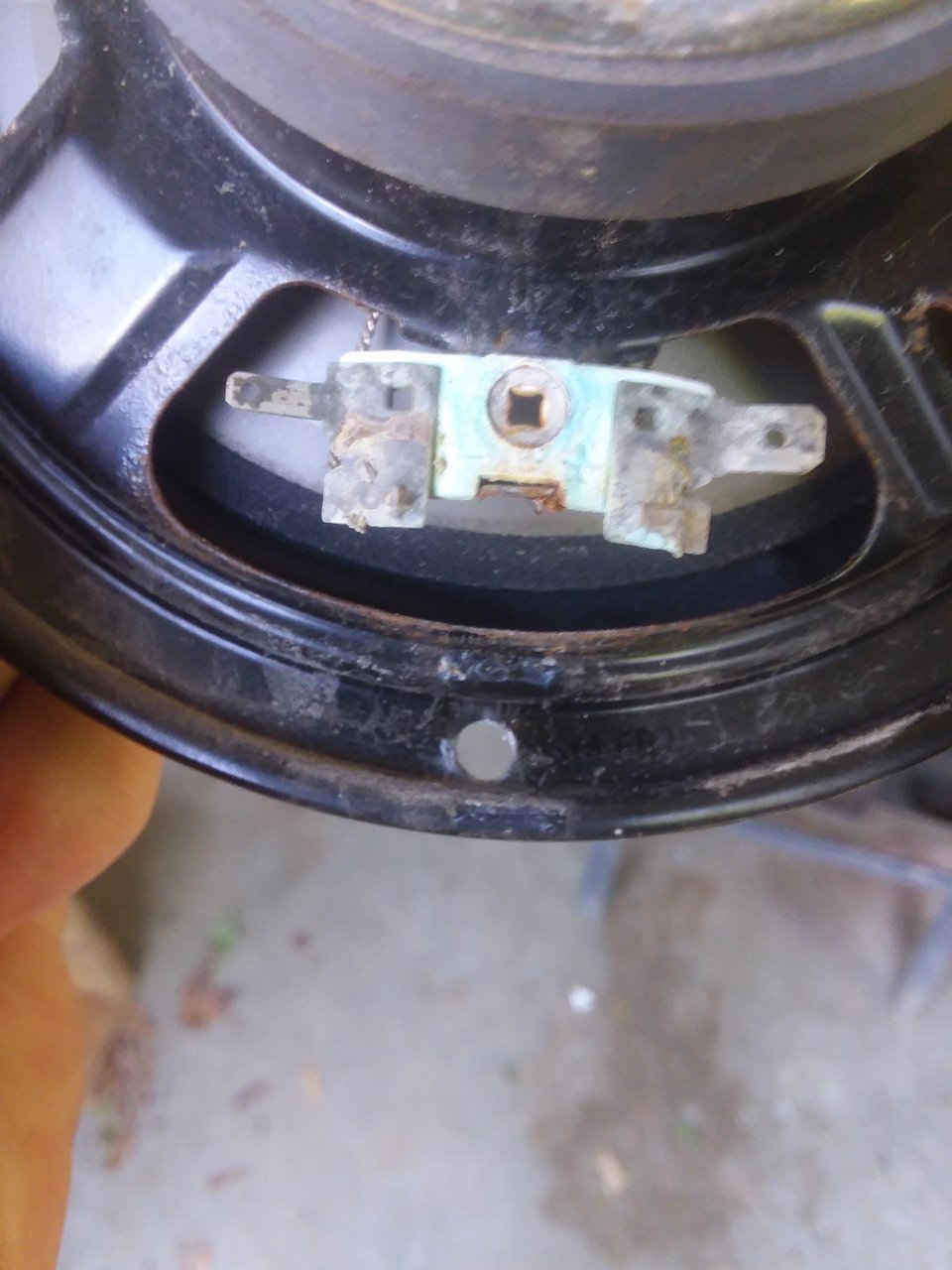

    Realized I had a dead speaker. The musicophile I am said: 'That should be fixed. Now.'
    This thing look like it's gotten wet to you guys? (the oxidization / rust on the connectors)

    That oxidation could just be from the flux in the solder. It's very common. To do a really proper clean up job on solder connections you need to use isopropyl alcohol and scrub it off with an acid brush, but even then you're not getting rid of all of it. The alcohol dilutes the flux and as it evaporates it removes most of the flux but some remains. That doesn't really look abnormal. The actual connections should look smooth and shiny like chrome when they are new. If it looks pitted you might have a "cold solder joint ".

    Appreciated, Moose.
