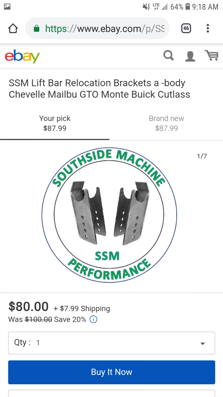

  11. DougA
    DougA Road Train Member
    1,429
    8,892
    Dec 16, 2013
    Retired,In my shop in Md.
    I used a similar lift bar. Southside machine bars were very popular in the day,and worked for most. It helped,but launching with a stick,without spinning is much harder,because I don't have that torque converter cushion. I'm one of the few dinosaurs that still drag races a four speed,it's just the old school factor,an automatic would be cheaper,and easier........but more boring. To me anyway.
