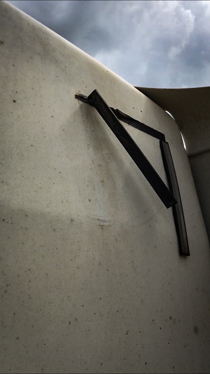

  6. ShooterK2
    ShooterK2 Road Train Member
    5,533
    89,470
    Dec 14, 2012
    Oklahoma
    Did y’all know that, when that Oklahoma wind comes sweeping down the plains, THIS will wake you up from a dead sleep?
    I guess the black sticky tape let go from all but one corner.
    Al. Roper, cke, Czar_Zero and 19 others Thank this.
