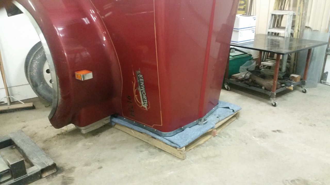

    I take a couple of pallets, or a couple old tires and a pallet, thick blanket to protect the grill. I just roll it over and rest it on pallet unpin it and back away from it. If you have a little fork lift it gets easier than that lol

    Kinda like this.

    That sounds easy enough, thanks! Beings I'm on a farm we have lots of pallets and old tires laying around! lol

    It in my opinion is easier. I even take bumper off but this time I'm going to try and leave it on and see how it goes.

    Pull the hood, I use a little forklift, a pallet and some foam but a couple guys works too.

    Thank you guys! I do have a forklift so I'll use that and a pallet. I'm glad I asked cause I was gonna try and fight it with the hood on.
