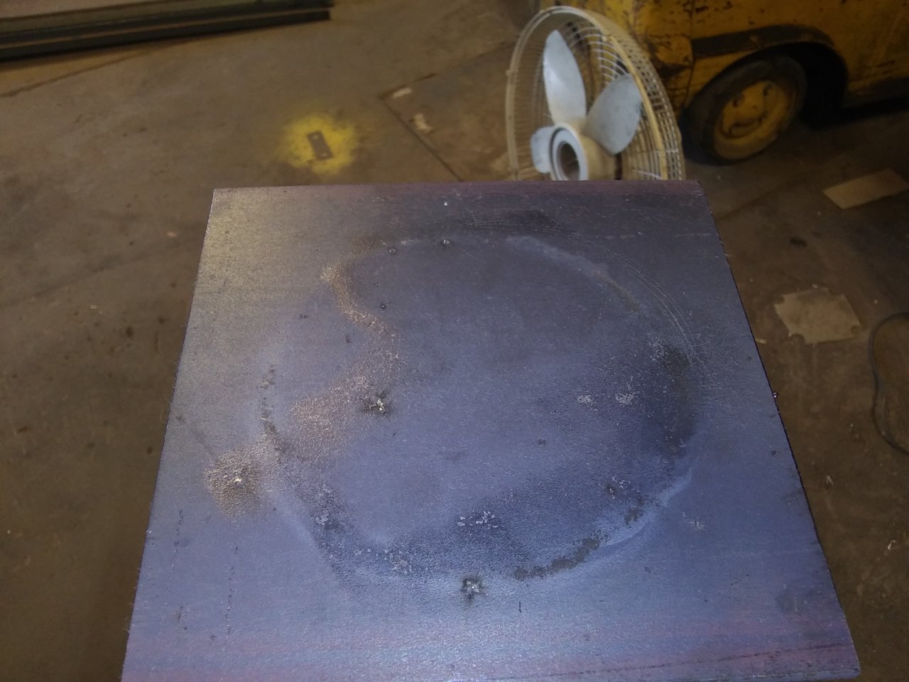

    This is the bottom of a 1/4" plate welded to a 4" piece of pipe. I used 1/8" 7018 about 140 amps. The ring is not a heat line, but displaced material that is pushing through from above. My mentor referred to that as "110% penetration".
    When you lean on a 6010/6011 rod, you will get the same result. It will generally take an additional pass to fill the undercut from the 6010/6011.

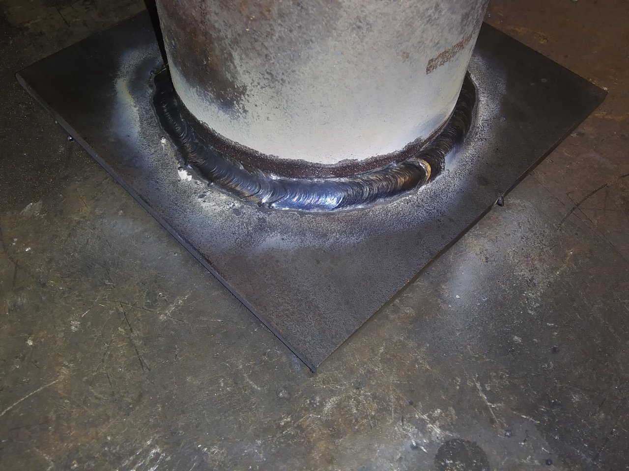

    Top view of the above plate.

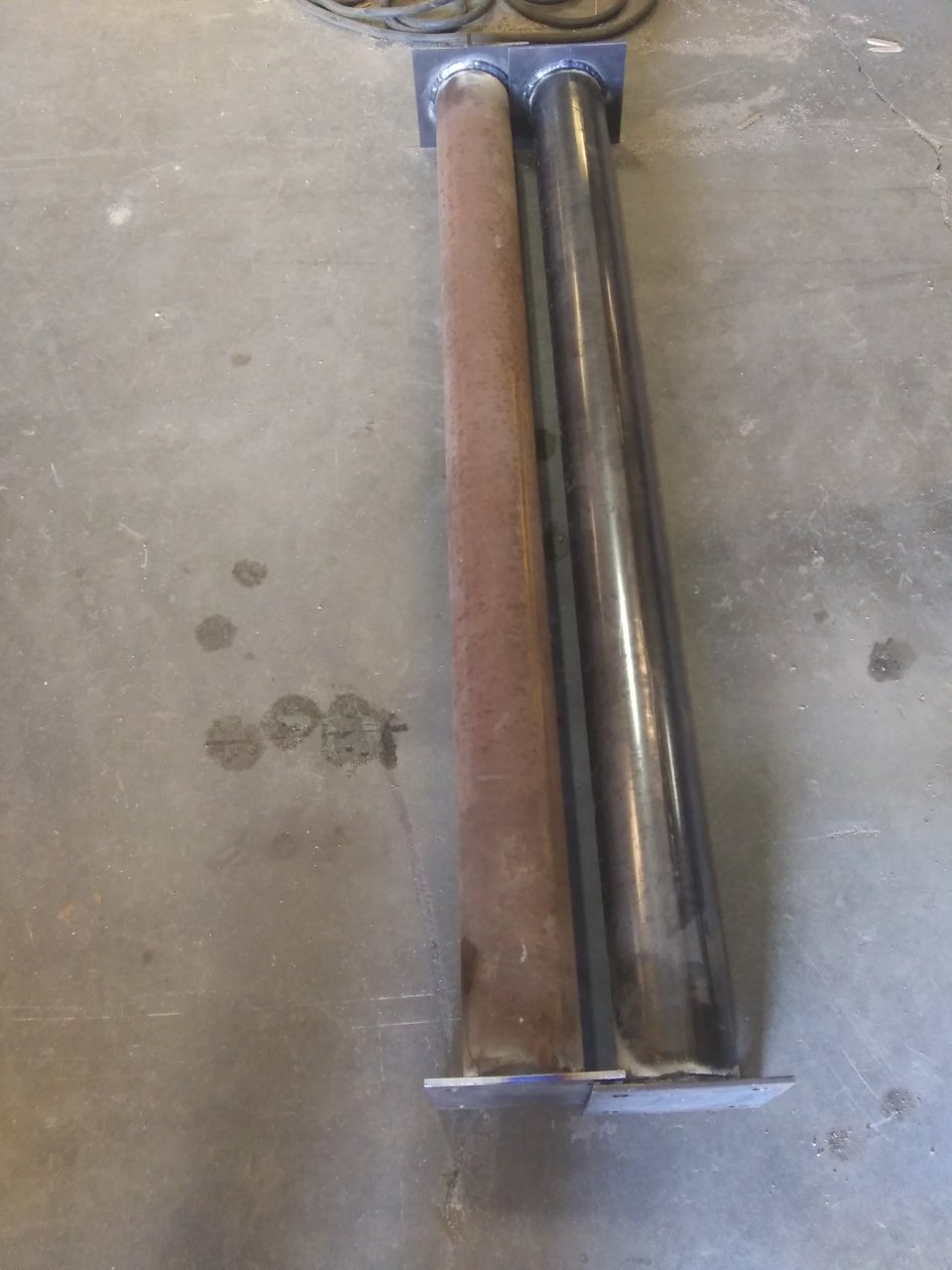

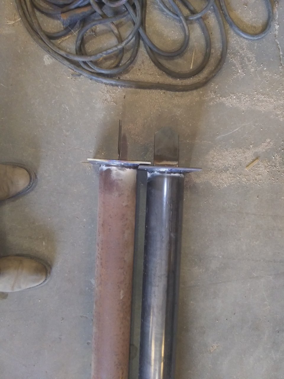

    The finished pieces. They are risers for a timber frame porch. They bolt the bottom plate to a concrete pier and build a cinder block box around this, then cover it with stone.The post has a pocket in it that slides over the tab. They drill a 1" hole through one side of the post, the tab and partway through the other side of the post. Then they drive a 1" steel pin to hold it down.
