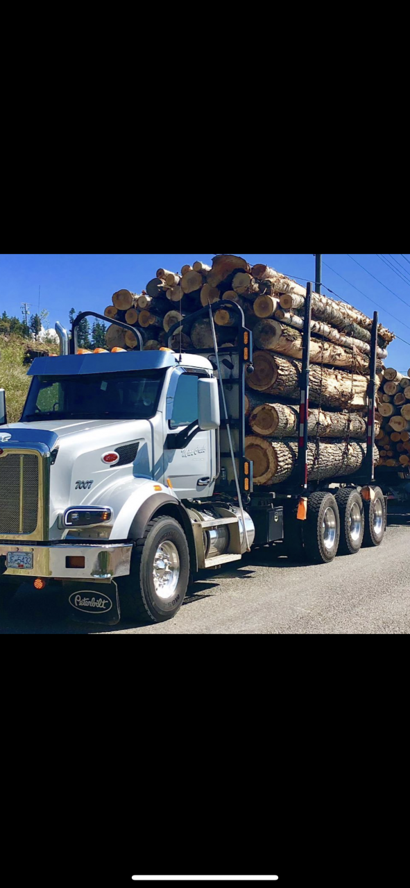

    7AC23622-2F46-4521-8DEB-9DA2D8DA260F.png Not my picture but same concept. We never tied down the logs to the frame. Just bundle the logs together in a sense.

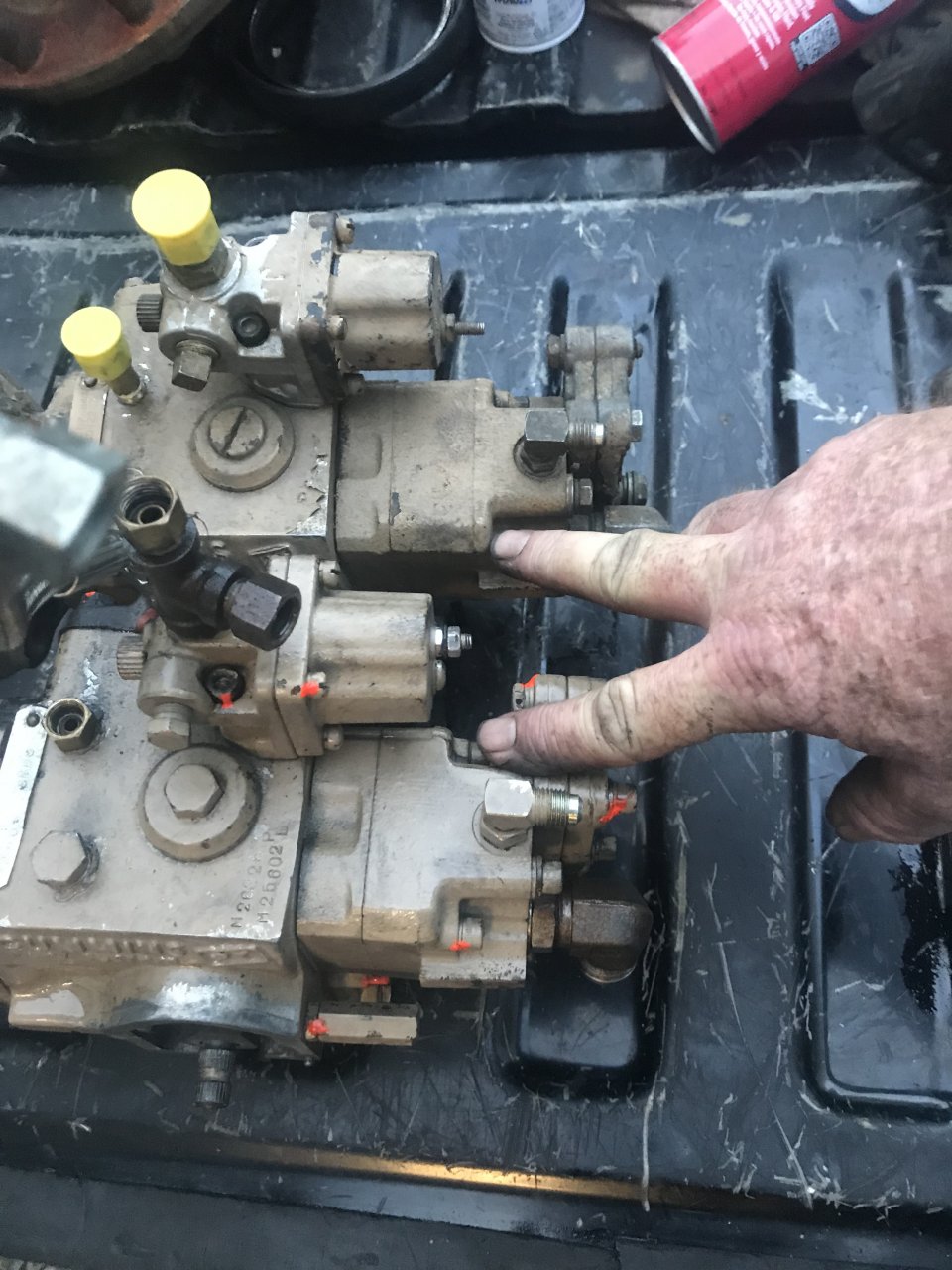

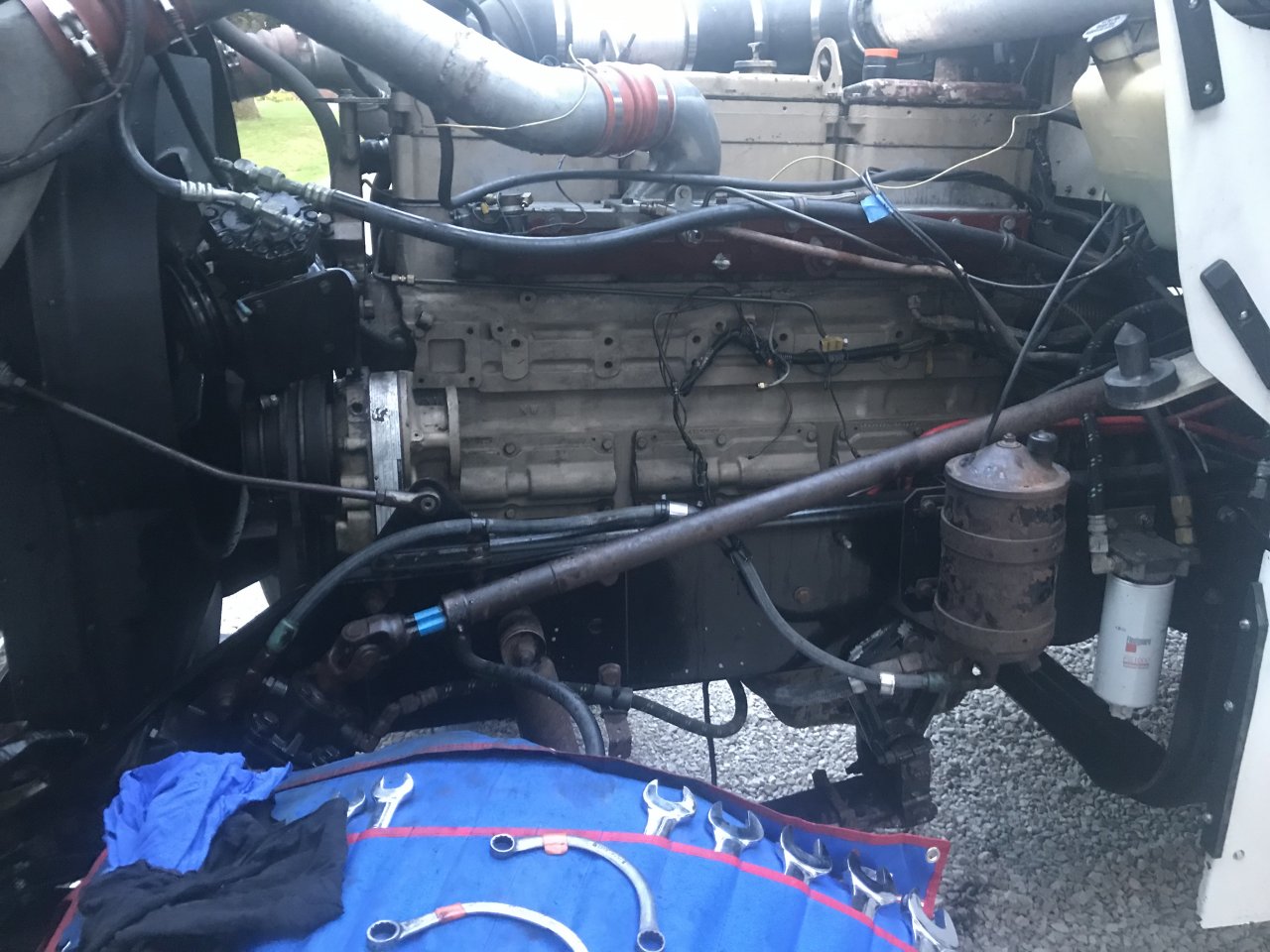

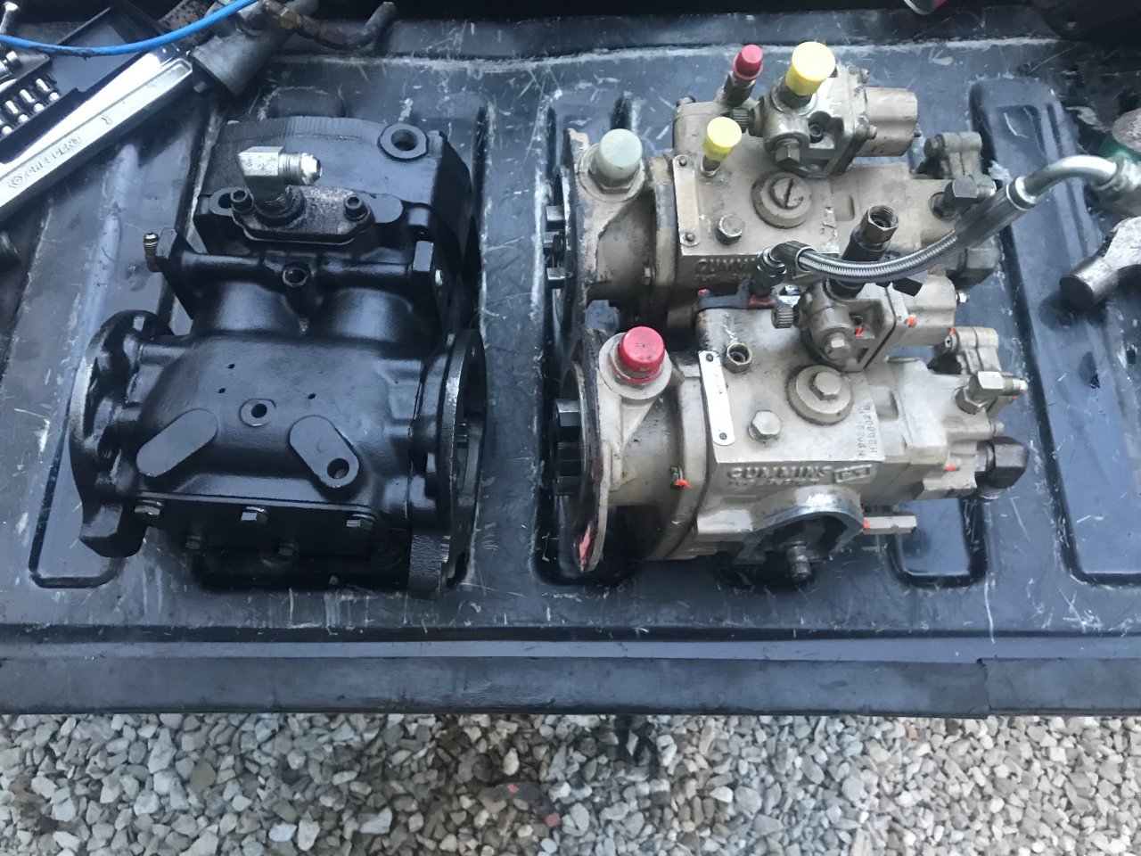

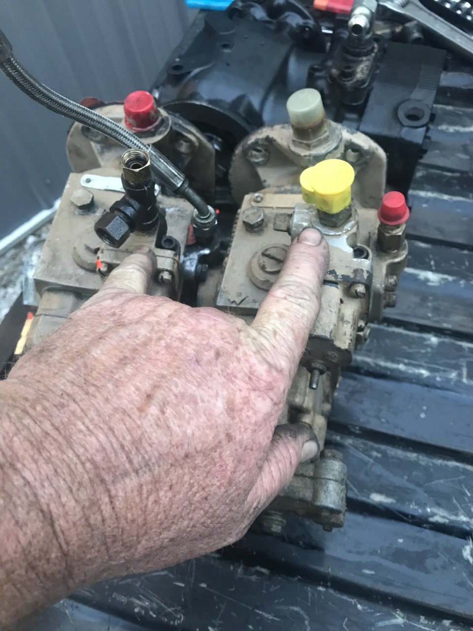

    8F9A8189-C1BC-4311-9D4B-3C54B83D852D.jpeg 77A0575A-E041-4893-8A1C-1428AE782DE3.jpeg AF1E04A0-BC09-48E8-89E4-1E03235243A8.jpeg 3AEA89A6-D12C-46EC-8A83-F62B61FC7E9C.jpeg
    Well guys Oldskool got caught with his britches down....
    Been meaning to go get my other pump rebuilt and have it on the shelf in case I need it. Seems the air compressor has been going bad and caused problems with my fuel pump, slowly went from 700 to 1050 rpms at idle over a about a week. Checked my fuel return line and no difference in idle rpm’s.
    Sooooo..... to get up and running it’s time to put the bad boy pump on and go!! The pump with the “yellow” caps is the BIG pump.... pressure ports on the solenoid on top are bigger and the pump on the back is bigger. Have to drive it with my big toe now....;)
