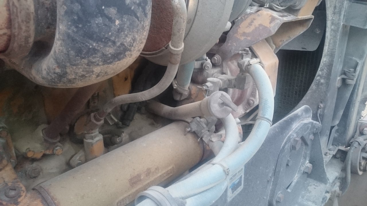

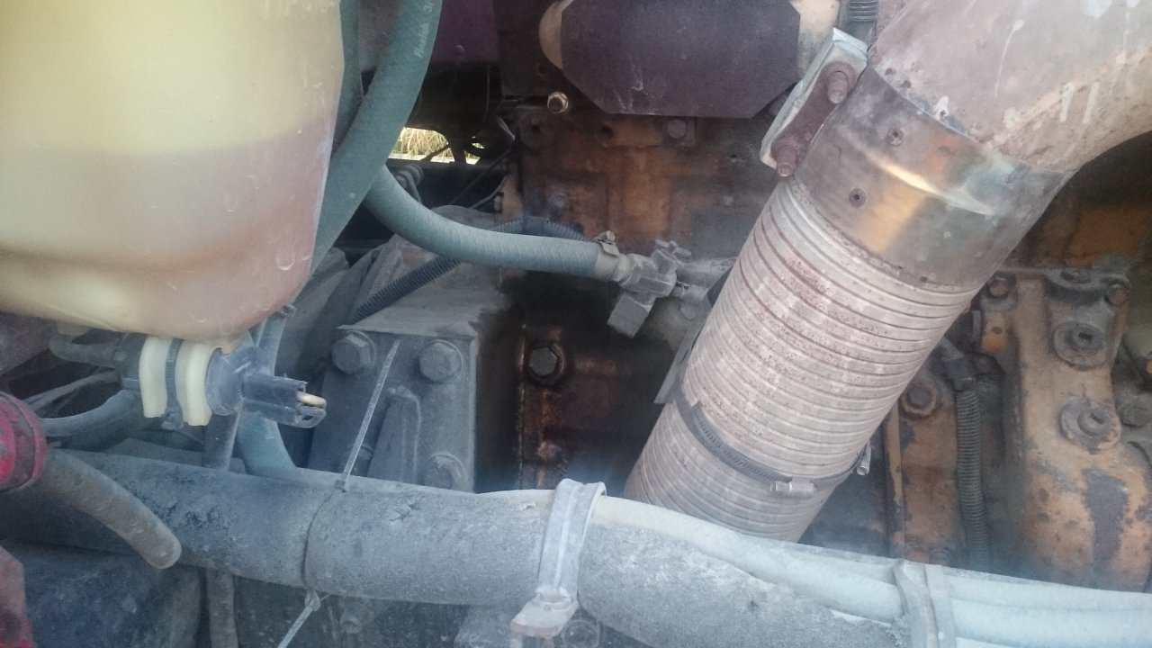

    Thanks.
    I might end up building my own three way manifolds.
    I need to make sure each line has a shut-off valve too. This is not easy to do without it looking tacky.

  6. Hurricane69
    Hurricane69 Road Train Member
    4,421
    59,740
    Sep 10, 2008
    Iowa
    I would switch where your top tank hose hooks on and where you have your heater hoses. The top tank hose will go down behind your turbo intake instead of sticking out there in the open.
    You could mount manifolds on the frame under the door would really clean it up.
    Post some pictures when your done. I used to buy alot of manifolds thru McMaster-Carr cause I got tired of making them. They are pretty cheap to buy and are usually there next day.
  7. sawmill
    sawmill Road Train Member
    3,976
    72,890
    May 29, 2015
    Evanston, WY
    That's the clean look I'm going for
    I'm going to see if they have what I need. I like the idea of of moving the manifold out of sight. Thanks.
