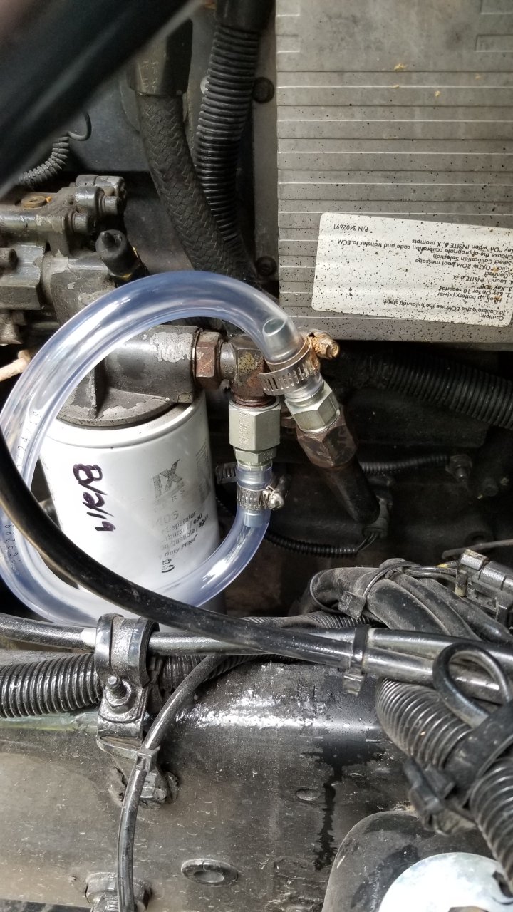

    Smaller rod and less heat.
    I've went to town and found the parts to make my fuel drain back testing device. 10 feet of clear tubing for 10 bucks and some 20 dollar jic 10 non ferruled hydraulic fittings.

    If you don’t mind posting some pics, that’d be cool. Sure might help a few folks out in the future.
    Let us know how it goes.

    Alright. According to quick serve you put an 18 inch piece of clear tube between the pump and the suction lines. If theres no air bubbles we arent sucking air. Once off a bubble will appear. If it moves back towards the tank within an hour theres a leak somewhere in the lines. If it doesnt move then the hard start isnt drain back related.
    Fittings I got from oriellys and hose came from home depot

    I like that.
    I might need to see about this “quick serve” deal.
