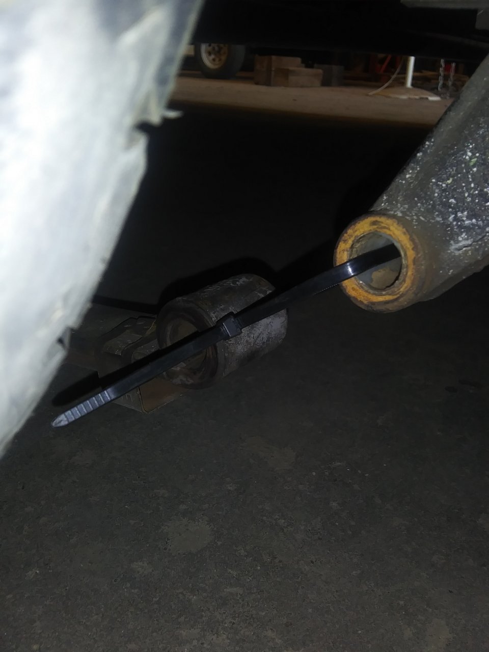

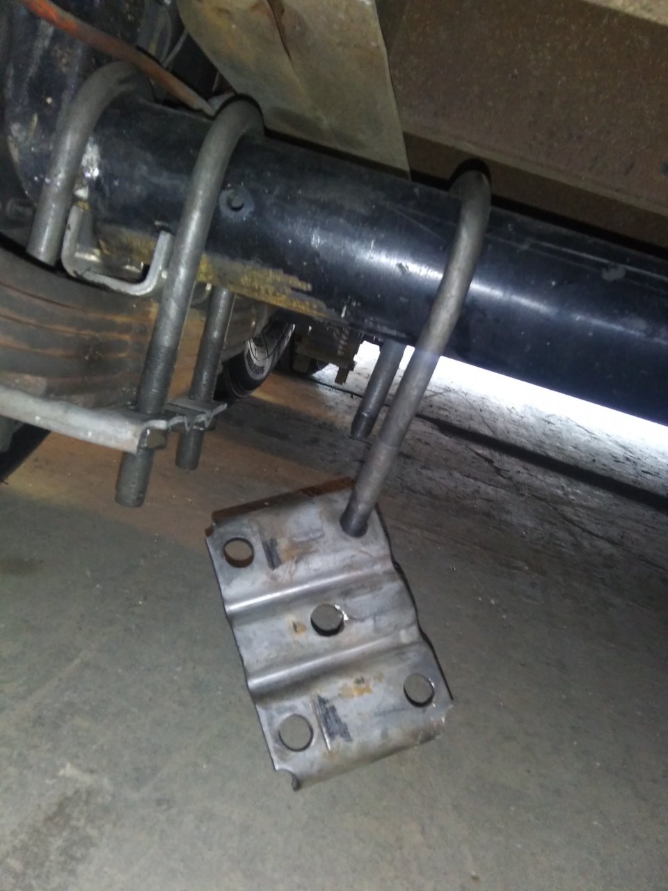

    Sure looks like somebody forgot to tighten the bolts recently when they replaced that mess.

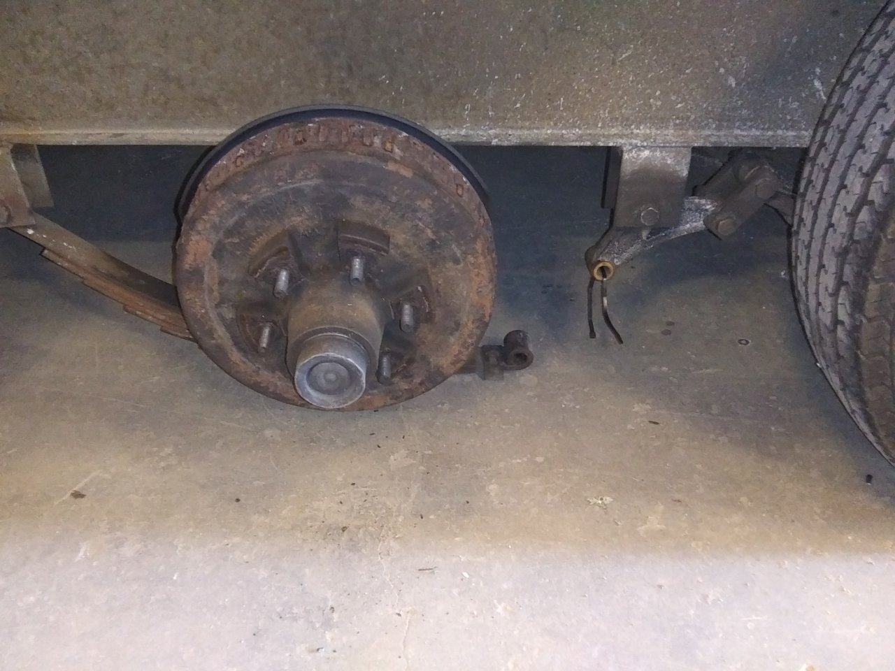

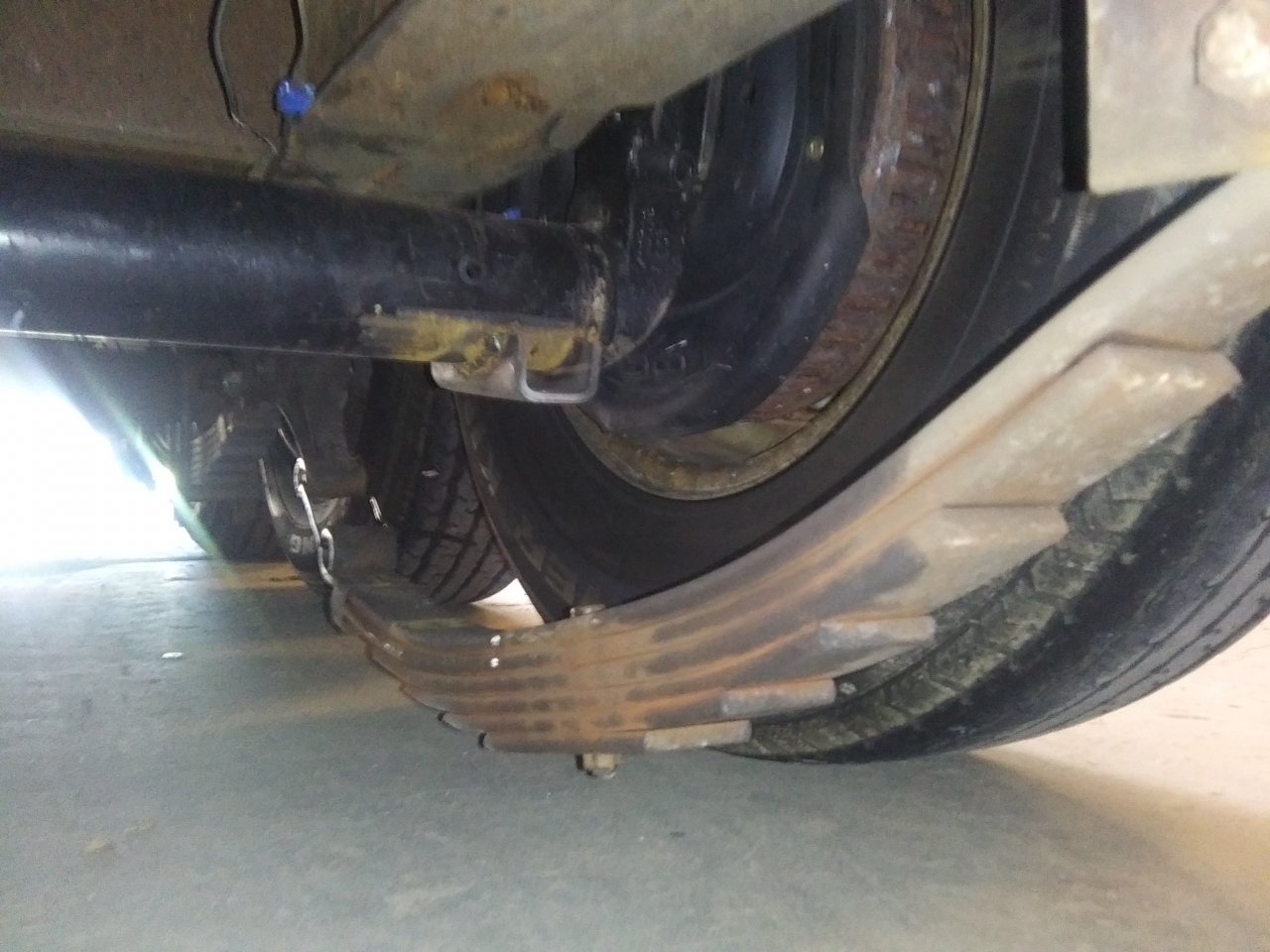

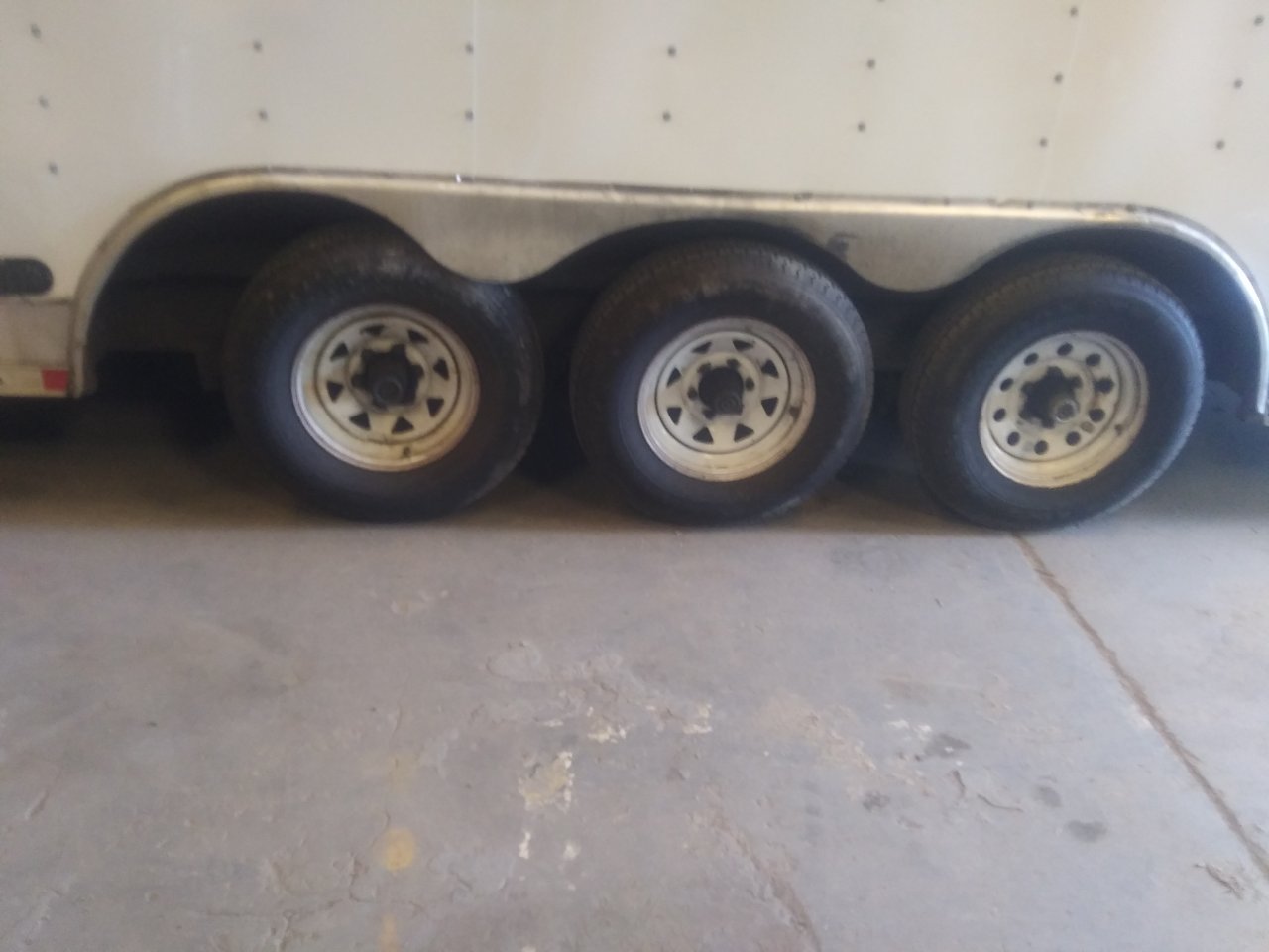

    They weren't. The driver had just left Chicago after this trailer went through their shop. Ironically, they are also a trailer repair shop. o_O
    All 3 axles had been recently replaced along with the U-bolts and U-bolt plates. No lock washers or top lock nuts on any of them, except for the 2 I replaced, they got lock washers.
    Notice the grinder marks beside the spring perch? They ground all the perches off and moved them out to mount these axles.
